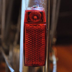

This instructable was created for the 2013 bike competition, It basically substitutes the dynamo system with a closed unit LED system that is triggered using a magnetic switch so to completely maintain the original look, integrity and beauty of the taillight while providing the convenience of a long-life lithium-LED set-up.

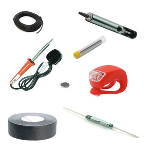

- Your original bike taillight
- 1 cheap LED bike light - One of the small ones, preferably red with a flashing function.
- 1 small Reed Switch - A type of magnetic switch, I salvaged one from an old cycle computer sensor, but any electronics store will have one.
- A small Neodymium Magnet.
- Some thin insulated wire - Again I salvaged some from the cycle computer, you don't need much, 30cm or so.
- Some decent Electrical or Gaffer Tape.
- A Soldering Iron, Solder and a Solder Sucker (If that's the way you roll).
- Willingness to part with tradition.

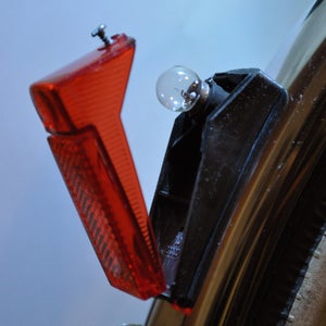

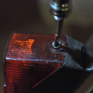

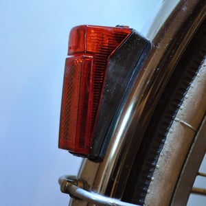

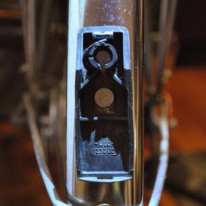

If your taillight is anything like most of my lights disassembly will be straight forward. Look for any screws and undo them. On my model the red plastic cover is easily removed by pulling it forward and up after removing a screw, exposing the bulb. You may need to squeeze the sides in order to release any plastic catches on other models but it shouldn't be too difficult.
Once the plastic cover is off, unscrew and remove the light bulb from within, if you want you can keep it to show your kids, one day.
As you can see there's STACKS of room inside these things. Keep in mind the general shape of your unit as we are going to have to eventually fit all our components inside, snuggly.
You can leave your bike alone now. Grab your LED stuff and crank up that soldering iron (Provided you know how to use one, careful now)

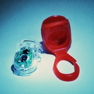

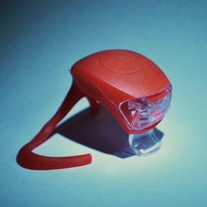

Here's a 2 quid light I bought from Tesco a while ago (Ok, it was a pair for 4 Quid). The silicone snapped but the light is still going strong so we're going to take the guts out of this light and modify it for our needs.
Start by removing the covering, on this particular light it's silicone and is easily removed with some wrangling, some similar lights that have a plastic outer shel and an elastic mount can be disassembled with a small screwdriver.
Step 4: Salvage.

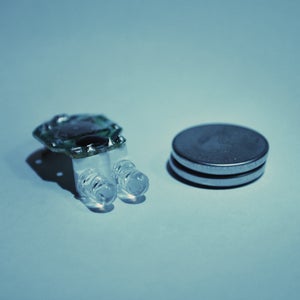

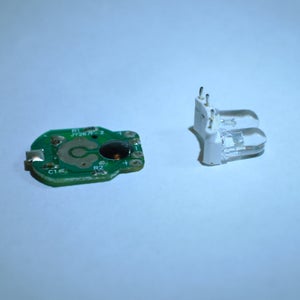

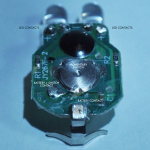

Once you've removed the cover continue by removing the main PCB (printed circuite board) and the batteries, these are the only parts we need.
Step 5: Desoldering the PCB
Now we're going to want to remove the LEDs/LED assembly, the battery contact points and switch contact points then replace them all with our own customisations.
Start by noting where everything is situated, the orientation of the LEDs and the battery orientation.

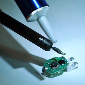

Start to remove the LED assembly, this is the most difficult part as you may need to use a solder sucker to clear the PCB of all solder before the LEDs will budge, take it slowly and don't leave the soldering iron on the PCB for too long as you may dammage the board.
The existing momentary switch may have some tape covering it, you want to remove both the tape and the small piece of springy metal that forms the momentary switch so the terminals can be soldered to.

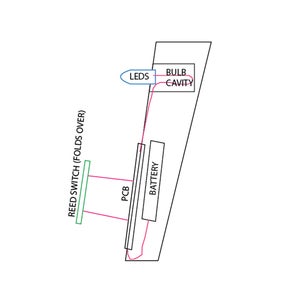

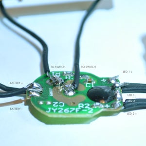

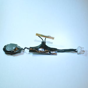

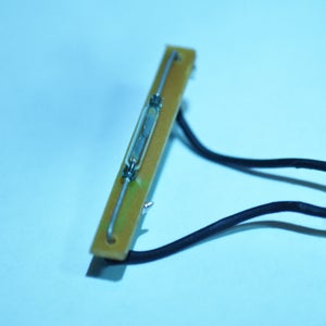

We about to solder the wires to the main PCB in order to fit the electronics to our light casing. Have another look at the casing and get an idea for roughly the length of it, we want to add enough wire to fit the casing correctly, see the diagram attached (Pink = Wires). Preferably the battery will sit flush against the back of the casing, the PCB sits over that and the reed switch to the side or any convenient place at the edge of the casing.
Solder the reed switch and the LED assembly to their dedicated wires.
Step 7: Add the Battery

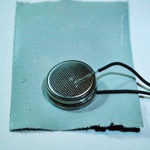

The moment of truth, complete the circuit by creating an enclosure for the two 3v batteries using a single piece of doubled over gaffer or electrical tape. As this will be the only part you'll have to tamper with in future (when replacing the batteries), keep the wires straight so that the batteries can be yanked off reasonably easily.
Before sealing the battery assembly hold the wires on the correct battery terminals then touch your Neodymium magnet to the reed switch briefly and check the circuit works. If not; Double check you got the polarity of the batteries right, if it still doesn't work check your LEDs are wired correctly and failing that troubleshoot - check over your soldering work.
If she lights up, seal the batteris and the PCB snugly and neatly in gaffer or electrical tape

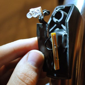

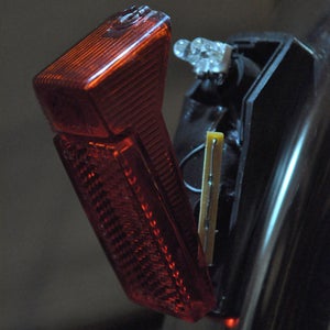

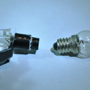

Now head back to your bike and roughly place the entire assembly in the casing by inserting the battery first and placing the PCB on top with the LEDs in the direction of the old bulb mount.
What you want to do is fold the wires so they poke into the bulb mount cavity, holding the LED assembly in place.
When you've shaped the wire satisfactorily use the old globe as a guide and wrap the wires to make a plug for the globe mount.
Step 9:

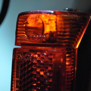

Return the entire assembly to the casing, putting the newly fashioned plug in the globe mount as well as fitting the rest of the components. You want the reed switch to sit as close to the edge as possible so that it can interact with the neodymium magnet's field without hindrance. Once you're satisfied that everything is fitting and nothing is getting caught when the red plastic cover is replaced close the casing and fasten any required screws.
And that's it, grab your magnet and test it out but swiping it over the area where you placed the reed switch.
