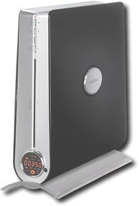

Step 1: The Original DVD Player and Radio Case
I got the case from a vintage radio repair man in town. The DVD player is a slot loading Insignia model http://www.insignia-products.com/p-140-insignia-progressive-scan-dvd-player-with-hdmi-output.aspx which I picked up for $50 at Best Buy. I needed a slot loading DVD player for this project and was a little surprised to find there are not that many slot loading DVD players on the market.
