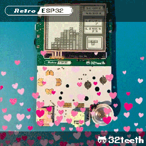

Game Boy Pocket - ESP32 Drop In Solution
Retro ESP32 is a Game Boy Pocket form factor, drop in solution for retro gaming.

Things you can find on this kit
  • 2.6" TFT LCD
  • USB (Charge Port, Serial Port)
  • Brightness Control Thumbwheel
  • Volume Control Thumbwheel
  • Power LED - 3mm diffused
  • New Conductive Pads
  • Headphone Jack (LM4857)
  • Speaker capability (LM4857)
  • Audio Amp (LM4857)
  • FULLY ASSEMBLED PCB

Step 1: Backstory
Why?
We love Hard Kernel and their amazing product base including the Odroid GO
We wanted to design, build and solution on trusted SoC. The ESP32 Wrover was selected for ease of use and extensive build tools available across all development platforms.
This STEM based ESP32 for your Game Boy Pocket is a real treat.
Features include:
  • 2.6" 320x240 TFT Display
  • Audio Amp (Headphone / Speaker)
  • Volume and Brightness Control
  • FTDI FT232RL USB UART
What?
The Retro ESP32 is intended as an educational 'toy' for the world of Makers
A low barrier to entry and NO soldering experience needed, AT ALL, there is NOTHING to solder, plug in and go!
It has full support for:
  • ESP-ISP Dev Toolchain
  • Arduino Toolchain
  • Whatever else you want to throw at it
This is a great opportunity to get your STEM on!
Really?
Yes, It's a drop in PCB with the form factor of the Game Boy Pocket
