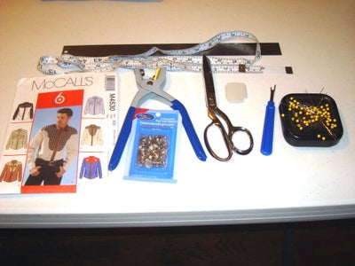

Step 2: Supplies
Sewing machine
Ironing board
Iron
Snap gun
14 (1/2 inch decorative snaps)
Measuring tape
Straight edge
Scissors
Seam ripper
Chalk
Marker
Sewing pins
McCall's M4530 Men's Pattern

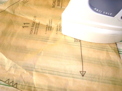

Step 3: Preparations
Cut out all pattern pieces that you will be using. I made view D.
Pre-wash, dry, and iron shirt fabric if you have not done that already.
Iron pattern pieces.

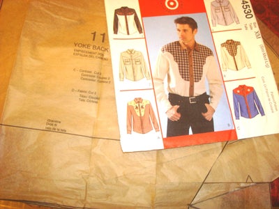

Step 4: Cutting Out the Pattern
To make this shirt longer in the body length and sleeve I had to cut the pattern where it says (to lengthen here) and extend it 4 inches in the sleeve, body, and front band. I add the length to the sleeves, body, and front band by placing the pattern pieces in place and extending the pieces the length needed. Using the chalk and a straight edge I drew the cutting line and cut the pieces. Please see the pictures.
Cut out all the pattern pieces making necessary changes as you go.
Mark all pattern pieces where needed.
If you wish to make the cuff pleats smaller don't cut out the sleeve until you read step 5.
For the most part I will write the pattern's instructions according to the pattern but will make notations where I changed them.

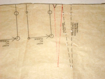

Step 5: Altering the Cuff Pleats
We did not like the pleats because they are harder to iron and added bulk to the shirt. We altered the pattern by marking the lower end of the sleeve taking off 1 and 1/2" at the cuff on each side and re-positioning the dart as shown. We began marking a slope from the middle of the sleeve tapering to the cuff section as shown on both sides of the sleeve. We tapered the sleeve to 3/4" at the cuff area. We could have taken off a full 2 inches and will do that on his next shirt. This will allow for a small tuck at the cuff area.
