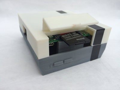

My project is a retro console , I also have access to a 3D printer and make my case for this little toy.
Here, the impression of the case
