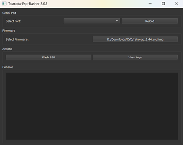

Step 4: Flashing the CYD
You will need to download the CYD RetroGo image file here: https://github.com/DynaMight1124/retro-go/releases/tag/CYD-RetroGo
Personally I use this program to flash: https://github.com/Jason2866/ESP_Flasher/releases
The CYD is fairly easy to flash thanks to a dedicated onboard flash chip and 'boot' button. To get the CYD in flashing mode, hold down the 'boot' button while plugging in the USB C cable (obviously while its also connected to a PC/Laptop) it will detect it and show up as a COM port. It may ask you for some drivers, if so, theres information HERE with drivers
Once you're ready with the CYD in flash mode, load ESP Flasher, locate the COM port for the CYD, select the CYD image file (may need to select All Files) and click Flash ESP and it should start flashing.
Note that when it finishes flashing, it'll reboot but you may see the factory menu auto scrolling. This will happen if the control panel isnt plugged in as its looking for an I2C signal. Unplug the power, plug in the control panel and it should then boot properly.
If you are still having control issues, I actually had a bad I2C cable when I originally built mine (the pins on the CYD end pushed out of the connector), changed the cables over and it was fine so keep this in mind.
