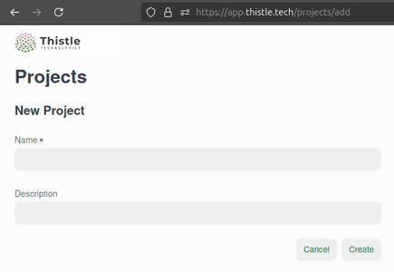

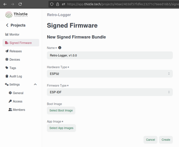

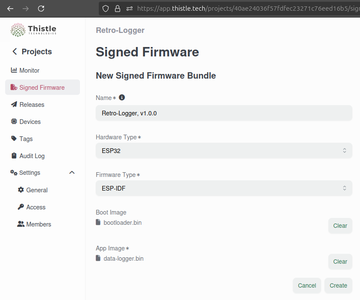

Step 13: Build and Sign the Retro-Logger Application (Development)
Now it’s time to build and securely sign your actual application - the Retro-Logger, which reads data over UART and sends it to Firebase via HTTPS.
1. Open a New Terminal & Launch Docker
- Navigate to your working directory:
- Sart the Docker container:
- Inside the container, set up the environment:
2. Prepare the Application Code
Copy the data-logger folder (from the GitHub repo we downloaded earlier) into the shared/ directory on your host system:
Open the file main/data-logger.c in a text editor and enter your WiFi and Firebase credentials:

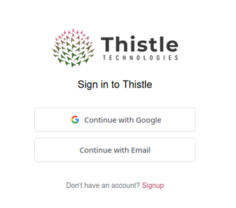

- On your host machine, open a browser and go to the Thistle Control Center.
- Create a new project (if you haven't already).
- Go to the “Signed Firmware” section.
- Click the “+ Signed Firmware Bundle” button.
- Fill out the form:
- Name: Anything you like (e.g., Retro-Logger v1.0.0)
- Hardware Type: ESP32
- Firmware Type: ESP-IDF
- Upload bootloader.bin and data-logger.bin from the shared folder
- Click Create.
Once the signing process completes, download the signed production firmware files from Thistle:
