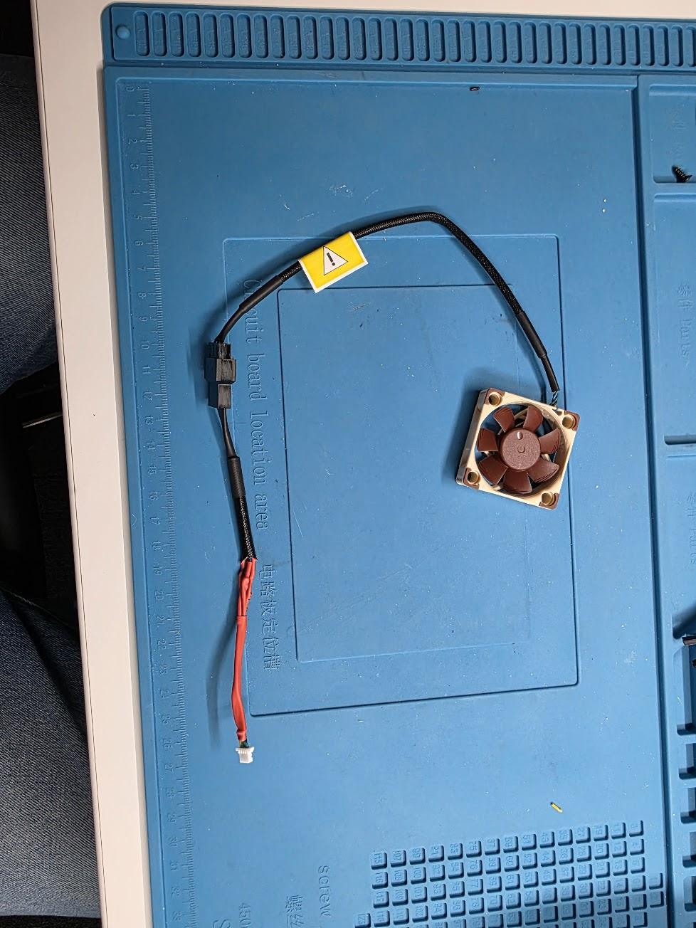

6) Prepare Fan connector - The Noctua fan pinouts do not match the Raspberry pi pinouts.
a) Buid the JST connector according to the pinout mapping. Small JST build your own connector kits can be found in online stores.
pinout Rapsberry Pi5 PWM fan pinout
Noctua PWM Yellow == +5V == Fan Header Pin 1 Raspberry Pi 5
Blue == PWM == Pin 2
Black == GND == Pin 3
Green == Tach == Pin 4
7) Attach fan to fan mount - Note the direction of air flow and orient the fan towards the CM module and heatsink.
