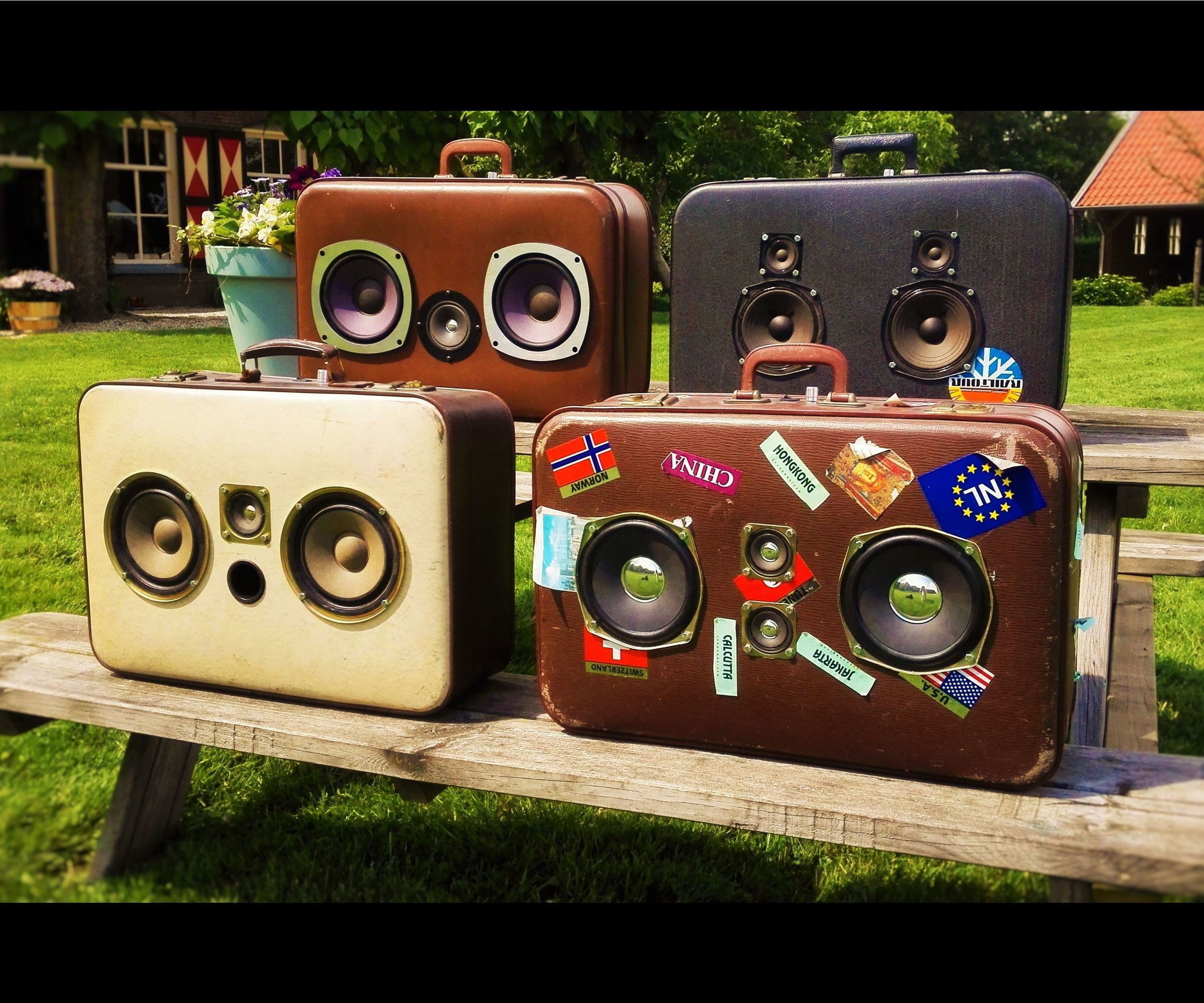

Portable speaker building has always been a great hobby of mine. This time i wanted to create a portable music system combining retro looks and quality components.
The suitcase is designed around a 90's BNS two way system. BNS is a well respected dutch hifi brand that saddly isn't around anymore. These speakers deliver a clear and deep sound, loud enough to fill a big room with music. The suitcase is controlled though the buttons on the backplate. It consist of a main power switch, a battery voltage checker, a light switch and a battery and bluetooth module charger. The backplate can be illuminated through a plexiglass rim as seen in the video. The suitcase itself is from the 50's and made of vulkanfiber by the dutch firm Bussemaker. Altogether with some wooden supports it makes a sturdy structure for the music system.
