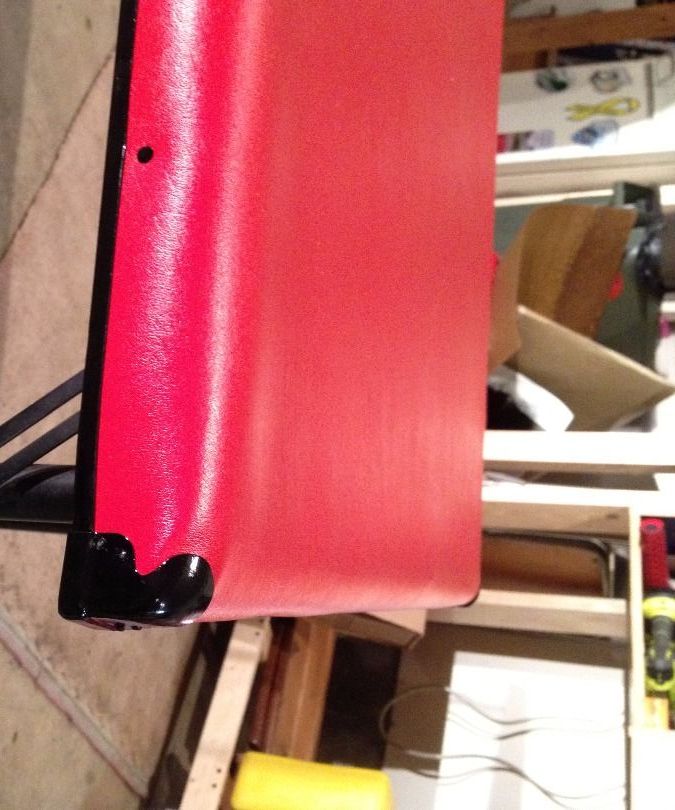

The camera lens at the front is made from trapezoidal sections of 1/4 plywood. At this point you have two choices, do math, or sand a lot. I chose to sand. I sanded the edges of the trapezoids until they sat flush together and sanded the back to let it sit flush with the front of the camera. The easiest way to attach them together, i found, was to use a nail gun and glue. The PVC pipe is installed last and is mounted at the center of balance for the camera. This allows it to pivot very smoothly and nicely. The Red handle is a stage brake. This stage brake extends into the wood holding the PVC and prevents it from spinning. This allows you to lock the camera in a specific orientation.

The plywood sides are attached and the Camera is attached to the base.
It works great and lasted through many shows.You can apply olive oil to the base and parts that need to rotate to keep it from squeaking and keep it moving smoothly. Hope this has helped!
