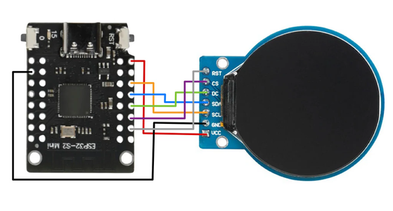

Step 1: The Circuit
Connect the Display to the ESP32:
Display -> ESP32
RST -> GPIO 3
CS -> GPIO 5
DC -> GPIO 7
SDA -> GPIO 9
SCL -> GPIO 11
Gnd -> Gnd
VCC -> 3V3
