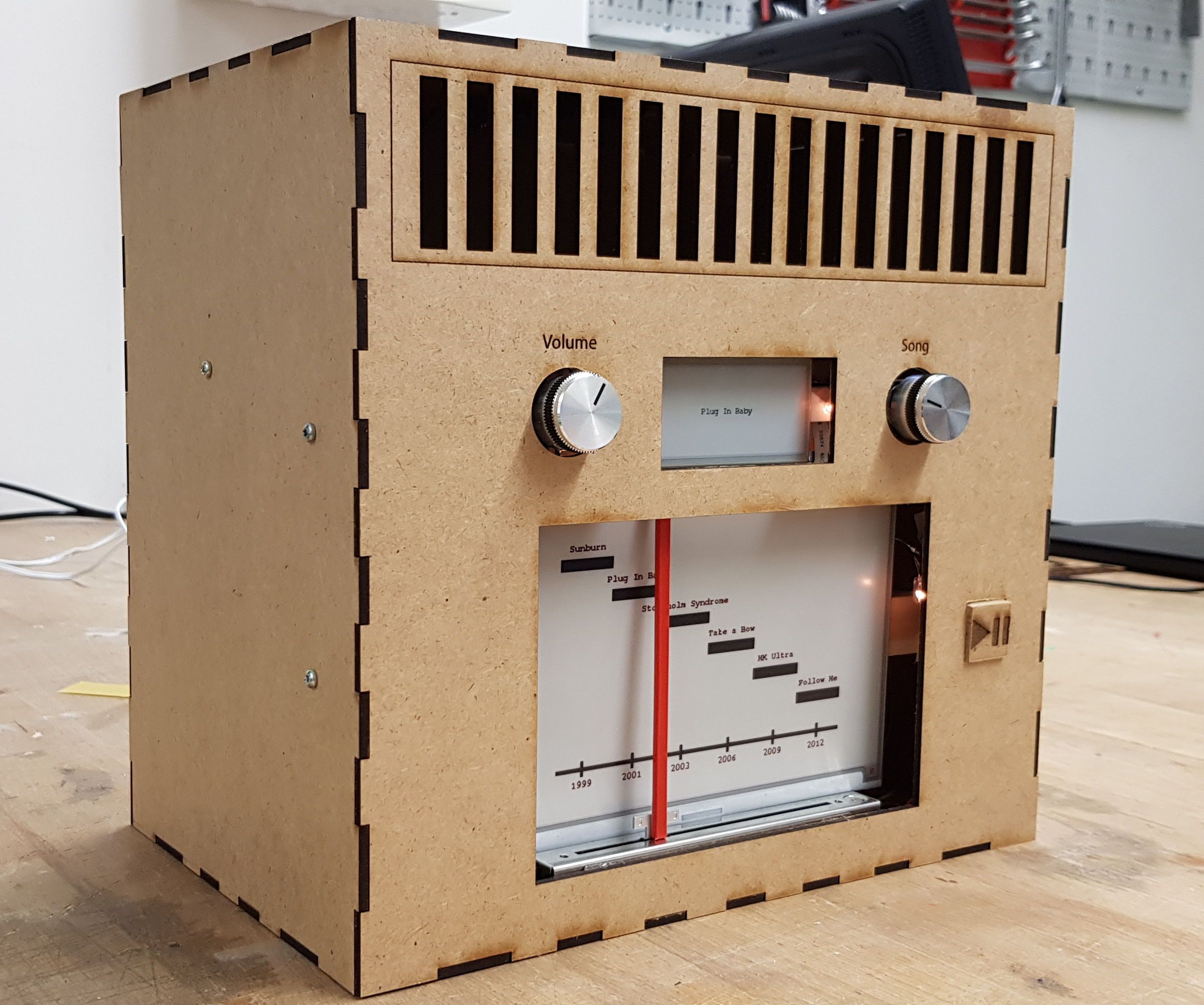

The idea is very simple: Take an old radio and modify it to play music from a Raspberry Pi. The goal was to have specific playlists which can be selected by the frequency wheel. The songs are grouped in chronological order by years from 1950 to 2010 and are stored on the intern SD Card. There are several buttons to play, pause and get the next song. An important aspect of the project was to reuse the old buttons. Using them gives the user an old school feeling. In order to additionally increase this feeling the radio imitates the typically noise between two frequencies.

We decided to reuse the frequency knob for selecting the year. Unfortunately we couldn't read out the generated values, so we took a multiturn potentiometer - the knob can make 5 whole turns, a normal potentiometer normaly only has a range of 270°. We glued it to the inner gear wheel of the knob.
Volume adjustment was still functional, so we used the build-in potentiometer for it and searched for the correct pinout.

From this point the real challenge begins to fit everything inside the case. We actually also opened up our USB Power Adapter and put it inside the old radio, so we could use its old power cord cable. Connect one micro usb cable to the Raspberry Pi and cut another USB cable open and connect the red wire to the + pin on the amplifier board and the black one to the - pin. Also wire the loudspeaker to it of corse and connect the Raspberry Pi sound output as well.

The last goal is to find some space inside the radio where the new hardware can be placed. If there isn't enough space inside -simply modify the housing with dremel or a tiny angle grinder by cutting it out slightly (Remember: safety first). Try not to damage the old circuit board and wirings - the less parts you remove, the greater the chance that the radio will keep its original functionality. The device we choose had a large battery compartment, where the Raspberry Pi Zero perfectly fitted in. You can also use a normal Raspberry Pi, if you have the free space for it in the device. Since our goal was not to save the portability of the radio, we decided to use this option to locate the most part of our hardware.
