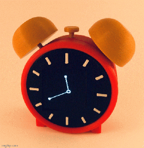

My Retro-ish Alarm Clock
So my new clock has the following useful features:
  • I redesigned the clock to be free standing and not just a façade mounted on a hex.
  • The clock is WiFi enabled and get's the correct time from the NIST Internet Time Service.
  • While QR code is still one of the available options, I have added a number of additional clock "faces" that are just a little bit more readable.
  • You can set a single alarm.
  • The alarm time and "face" selection are saved to non-volatile memory in case of a power outage.
  • I don't know if cute is useful but it doesn't hurt.

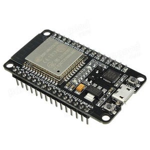

  • 1 - ESP32 Development Board Wireless WiFi + Bluetooth Dual Core Module (Amazon).

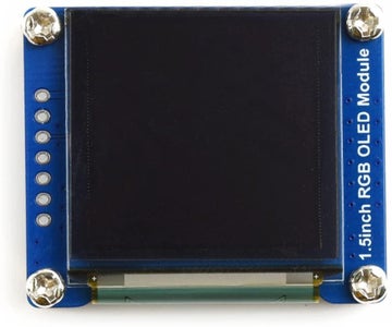

  • 1 - Waveshare 1.5inch OLED Display Module 128x128 Pixels 16-bit Grey Level (Amazon).

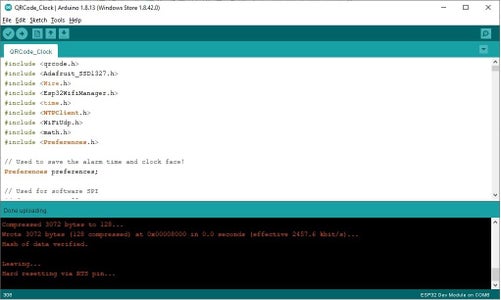

Step 2: Install the Clock Sketch
Connect the ESP32 to you computer and install the attached Sketch. Before downloading the Sketch change the following lines to connect to your local WiFi network:
// Used to retrieve the NTP time.
const char* ssid       = "Your SSID";
const char* password   = "Your WiFi Password";

Start by wiring the display to the ESP32. The wires that shipped with the OLED display were too long, plus there was not enough clearance to use the attached female connectors, so I cut the wires at about the half way point and soldered them directly to the ESP32 headers. Here's how to wire the display:
OLED Display    ESP32
VCC (Red)        V3.3
GND (Black)      GND
DIN (Blue)       D21
CLK (Yellow)     D22
CS  (Orange)     D14
DC  (Green)      D27
RST (White)      D26
Install the two push buttons, power jack, and the buzzer with a common ground and leads to connect them to the ESP32 as show in the second photo above.
Slide the ESP32 into the slot on the clock back with the headers pointing up. Attach the push buttons, power, and buzzer:
Component       ESP32
Power+ (Center)  VIN
Power GND        GND
White Button     D04
Black Button     D33
Buzzer           D05
Position the buzzer with the wires facing up beside the power connector above the hole in the clock back.

Attach the stand-offs to the OLED Display using the provided screws. You will have to remove the connector from the OLED Display to push it through the hole in the Retro Clock Display Back from the back. Reconnect the OLED Display and use the 4 M3 screws to attach it to the top of the Retro Clock Display Back using the stand-offs.

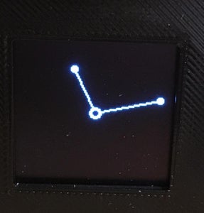

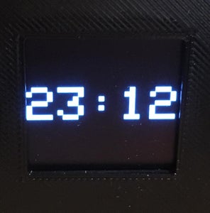

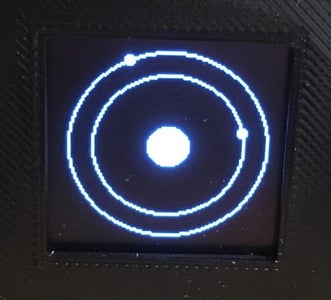

If you repeatedly press the the white button, the clock will cycle through the four face types seen above. The first three are pretty self explanatory. The last image above shows my "orbit" face. The inner "planet" circles the "sun" at the center once each hour. The outer planet takes 12 hours to circle the sun.
To set the alarm, press the black button once. You should see a 24 hour digital display with the hours blinking. Repeatedly press the white button to set the alarm hour. Press the black button again and set the alarm minute in a similar fashion using the white button. Press the black button one more time to save the alarm settings and return to the clock display.
