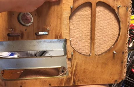

First ,disassemble the old set.
There is only one speaker in the left side of cabinet. In spite of such symmetrical looking, there are not any speakers behind the right side speaker grill.There is only a wooden board without any holes So for the first step we will cut out another speaker hole
Remove the old grill cloth and cut out the same shape of the hole for speaker on the other side.
