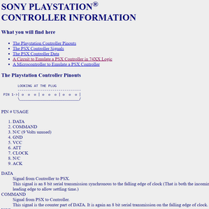

Step 2: Design
Go tk PSX Controllers (gamesx.com) to learn more about emulated controller schematic.

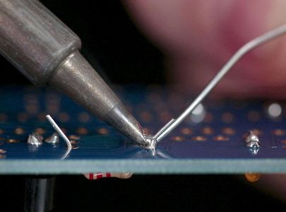

Step 3: Soldering
Solder all the controller buttons and joystick to the PCB. Soldering must be done carefully.

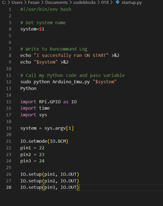

Step 4: Fix RetroPie If You're on Pi 3b+
make the starup.py file and paste this code in it:
#!/usr/bin/env bash
# Get system name
system=$1
# Write to Runcommand Log
echo "I succesfully ran ON START" >&2
echo "$system" >&2
# Call my Python code and pass variable
sudo python Arduino_Emu.py "$system"
Python
import RPi.GPIO as IO
import time
import sys
system = sys.argv[1]
IO.setmode(IO.BCM)
pin1 = 22
pin2 = 23
pin3 = 24
IO.setup(pin1, IO.OUT)
IO.setup(pin2, IO.OUT)
IO.setup(pin3, IO.OUT)
Pins will be automatically directed to USB using our controller.
