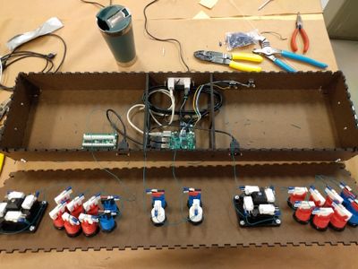

Now that you have cut out the case, it is time to assemble the case and components
I could go into incredible detail here but it is pretty self-explanatory, the case press fits together and then you bolt it on, attach handles, secure the Raspberry PI and IPAC-2, install the supports, attach USB ports/, screw on power/reset buttons, etc. - please feel free to reach out if you have any specific questions
Step 4: Step 4: Wiring
I started with the power and reset switches, then I wired up the buttons/joysticks
For the buttons and joysticks, this site put together by Ultimarc is your best resource
This is how I chose to wire everything up in case you want to follow my steps verbatim
