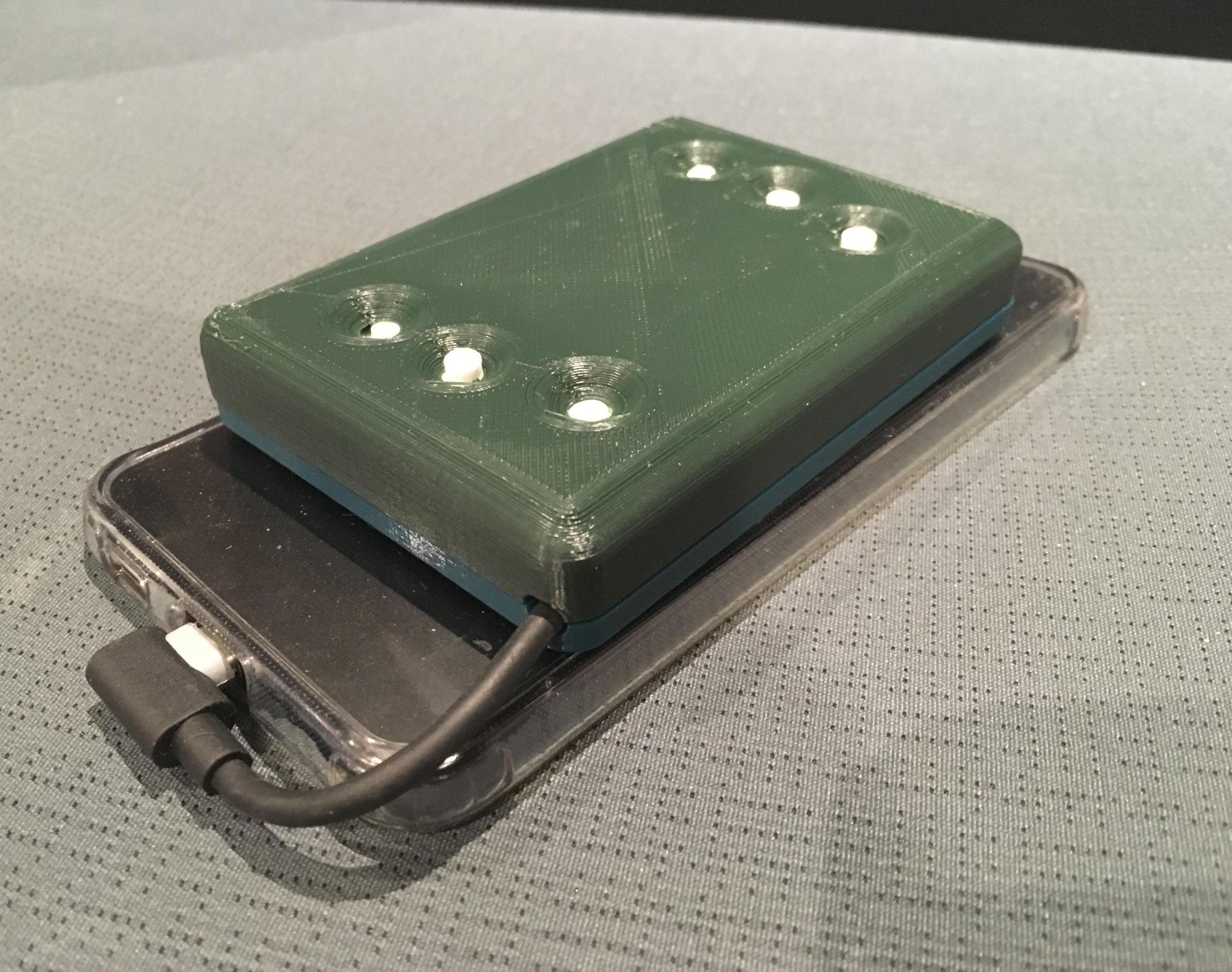

Step 6: CADing the Housing
For the housing of the synth, I wanted something that took advantage of the modular nature of the original laptop, and after looking at each removable component, I decided on basing the housing off of the battery. Not only was it the largest removable component, but it was also directly beneath the top left section of the keyboard, which was where I wanted to put the knobs/potentiometers. Therefore, if I molded my housing to fit exactly where the battery used to be, I would be able to seamlessly hide the electronics.
I first took a photo of the battery, then imported into Fusion 360 so I could trace its general shape onto a sketch. Then, I extruded it, hollowed it out, added standoffs for the perfboard, modeled the snap fit features on the side of the housing.
Initially, I wanted the output of the synth to be the headphone jack of the laptop itself. However, I realized that since it was a SMD component, it would be really hard to desolder and reuse, so I opted for mounting a separate 3.5mm audio jack onto the housing itself. As such, I modeled a mounting hole on the side.
Step 7: Printing the Housing
I was able to get two of them printed at my school, and they turned out really good. However, when I tried inserting it to the battery slot, I realized that the tolerances were way too tight, and I couldn't get it out. I eventually removed it with a pair of pliers(destroying it in the process), leaving me with one good print and the realization that once it was time to put the electronics in, I had essentially one chance as I wouldn't be able to take it out again without mangling it, and didn't have to time to go get another batch printed.
