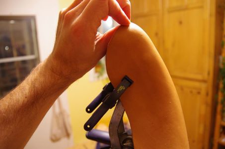

Form the leather
You could use here many different ways to mould the seat, like using a male-female foam mould, or even by vaccum-moulding it, see step 9 for references. I chose a simple low-tech one.
However, the leather forming part is crucial. If I were to do it again (which I might for another seat), I'll try another more precise way of moulding. My "moulding" left some imperfections, but let's say they contribute to the seat personnality !
- Pour some room-temperature water in a large pan, large enough for the piece of leather, and let it soak for few minutes.
- Gather all the clamps you have. Lots of small ones if possible.
Notes :
The clamps may mark the leather, sometimes forever. Using more, smaller, weaker clamps helps avoiding this. You may want to hold the leather on the extra inch you kept.
You can also use plastic bags that you'll tie around the seat to hold it. - Place the leather on top of the seat frame, and start forming it : first by hand, then hold it with the clamps. Take your time here : the leather is very flexible and stretchable, so work it slowly to achieve the shape you want. Stretch it or compress it where needed.
- Pay attention to the sharpest "angles" : at the nose and at the back. I used mostly my hands for the nose, but also a broomstick and a wooden spoon !
- Let dry completely (about 1 or 2 days) and regularly check if the shape holds well.

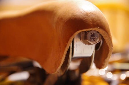

Step 5: Adapt the Frame : Adapting the Nose (Tension Shackle)
I had to build the tension shackle. This part :
- holds the tension pin (the bolt)
- is where the tension pin "pushes" the nose-piece from
I used a T-hinge I had around, since it was very close to the final shape I wanted : some kind of triangular shape that'd be bent around the frame. Here's what I did :
- Cut some groves to be able to fit the piece between the two horizontal rods.
- Half-bend the piece
- Cut the piece to the desired shape
- Insert and give it the final shape
- Drill a hole, using the existing hole (on the back of the piece) as a guide. (step not shown)
Step 6: Adapt the Frame : Creating the Nose Piece and Tension Pin
The nose piece-tension pin combination is what allows you to tension the leather. This is necessary for a setting it up, and adjusting the saddle as the leather will get slack after some time. This is how it works :
- the tension pin is fixed to the nose piece so it cannot rotate
- by screwing or unscrewing the nut that rests on the tension shackle, the nose piece + tension pin will move forward or backward, to adjust the tension of the leather.
You may want to build your nose piece differently base on the specifications of the seat frame you have.
The nose piece needs to be strong : I used a thick T-plate as a starting point.
- Bend the plate to the desired shape (pic 3)
- Cut the unneeded parts ans smoothen the edges (pic 4)
- Drill the necessary holes (see notes on picture 4... I only had to drill one) :
- one for the tension pin
- one on each side, and one atop of the tension pin's one. - Drill two or three (to a larger diameter) nuts that's serve as thick washers, since I figured it could be useful to have some way to better hold the tension pin (the bolt) in place. (pic 5-7)
- Put everything into place (see notes, pic 8-10)
