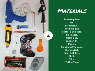

Soldering Iron.
Tin.
Screwdriver.
Hot glue gun.
Cutter / Scissors.
Flat cable.
Game pad.
Balloon #7.
Pencil.
Plastic bottle caps.
Microswitch.
Mini Drill Bits
Drill.
Clips.
Teflon Tape

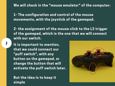

We will check in the "mouse emulator" of the computer:The configuration and control of the mouse movements, with the joystick of the gamepad.
the assignment of the mouse click to the L2 trigger of the gamepad, which is the one that we will connect with our switch.
Now...

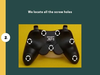

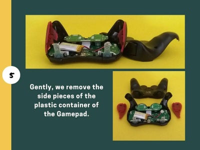

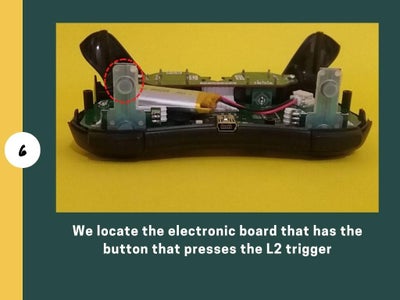

We locate all the screw holes. and we remove all the screws,
Gently, we remove the side pieces of the plastic container of the Gamepad.
Step 2:

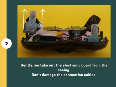

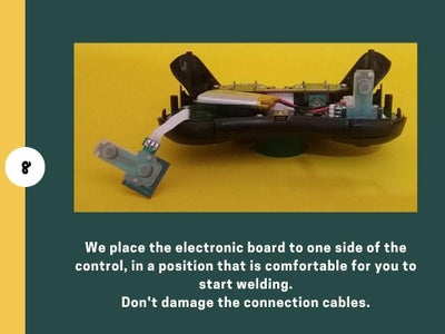

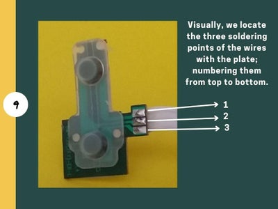

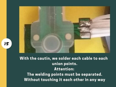

We locate the electronic board that has the button that presses the L2 trigger

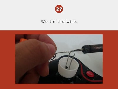

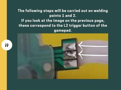

The following steps will be carried out on welding points 1 and 2.
With the cautin, we solder each flat cable to each union points.
Attention:
The welding points must be separated.
Without touching it each other in any way

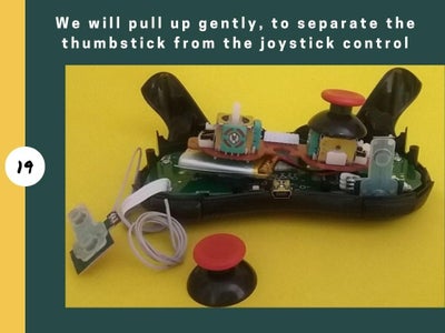

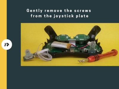

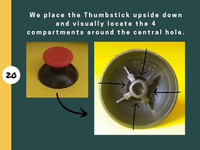

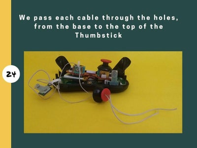

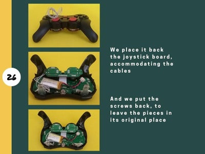

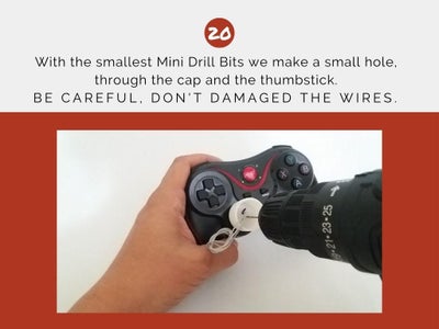

Gently remove the screws from the joystick plate.
We will pull up gently, to separate the thumbstick from the joystick control.

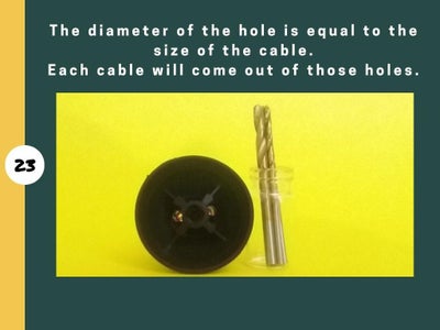

With the "Mini Drill Bits", from the smallest to the bigger, we begin to make a hole in each compartment that we select.
We pass each cable through the holes, from the base to the top of the Thumbstick.

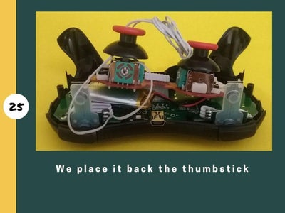

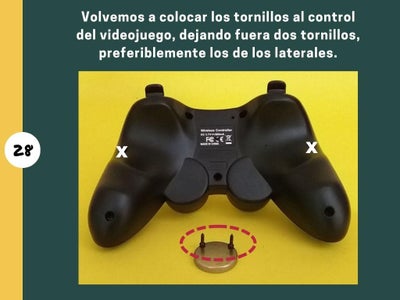

We place it back the thumbstick
and we reassemble the control by putting all the pieces back into place.
we left out 2 casing screws that are not so necessary

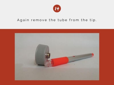

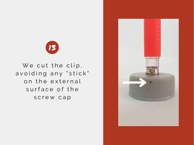

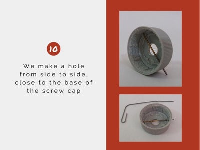

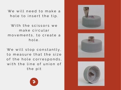

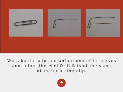

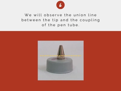

With a sandpaper we smooth the inside of the soda caps, so that one enters the other.

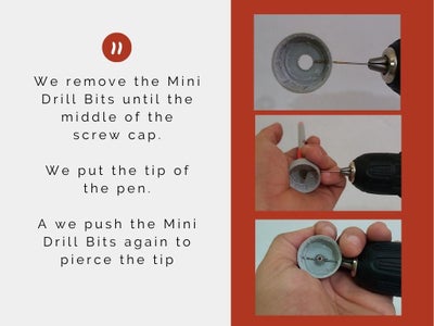

We make a hole in one of the lids the size of the tip of the pencil
We place the tip of the pen in the hole and hold it with a side clip and silicone

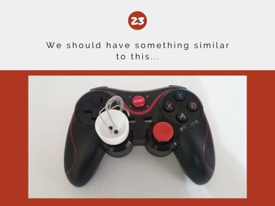

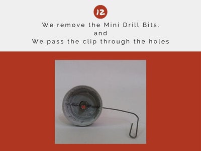

Step 5:

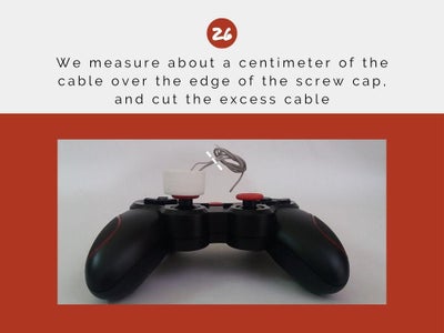

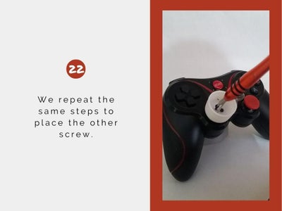

we make 2 holes for the cables, and we place the soda cap on the thumbstick
securing it with the two screws.
Be careful not to break the wires.

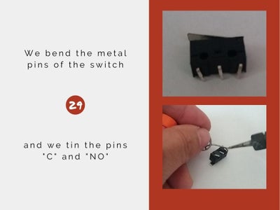

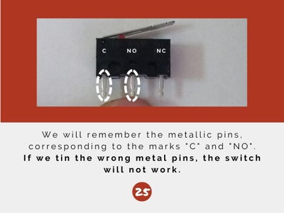

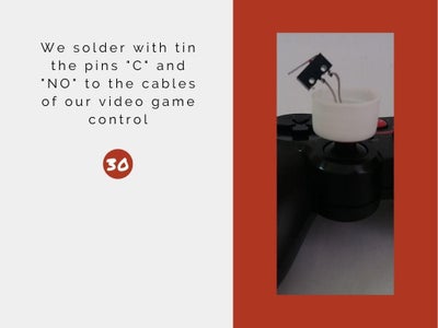

We solder the wires to the switch and place it with silicone inside the soda screw cap
Step 7:

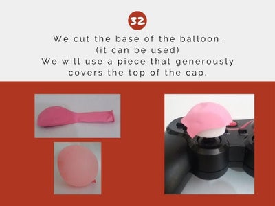

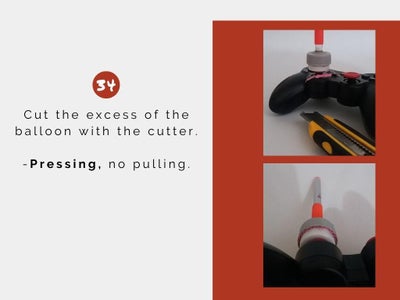

We cut the edge of the balloon to have a circle that we will place between the soda caps,

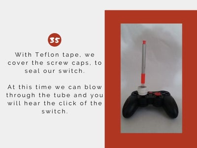

we seal the side air vents with teflon tape

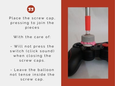

to form a diaphragm that activates the switch with the blow.

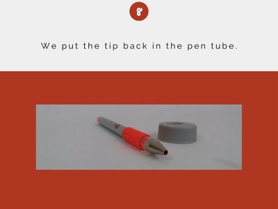

Step 8:

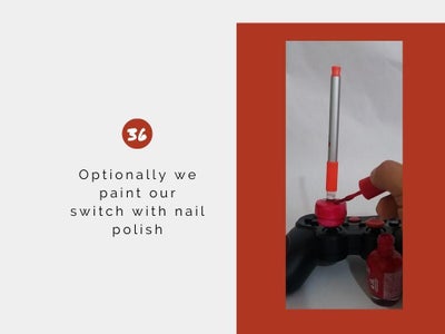

when placing the rest of the pen when you blow you will hear the click of the switch
now you just need to connect it to your computer and use any emulation program compatible with the control you adapted
