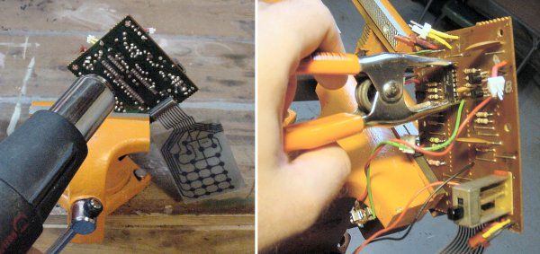

Many moons ago, I was heating some heat-shrinking on a wire and the heat-shrink slid off the wire and the heat gun was heating the solder on the alligator clip and it melted the solder makeing the clip fall to the floor(it was late night and I didn't use my robotic arm, to hold it). I thought it was stupid, but I did what I did and put the heat gun to a random pcb board and it worked! Ok enough story time!!

Step 3: Heat It...
heat the spot where the component(s) that you would like to get and shake the board a little bit.
