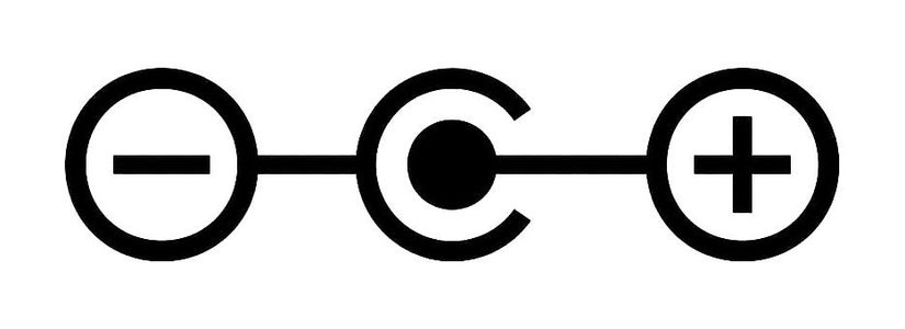

If in doubt, you should measure the voltage at the wall wart's plug. Don't forget that the no-load voltage will always be higher, sometimes considerably higher, than the voltage under nominal conditions! Refer to the type label - there, the plug's polarity should be given as well, usually by a pictogram.
The pictures above show
  • a barrel-plug socket of a device, with voltage, current and polarity indication
  • a type label of a P-Touch device, with battery type and power consumption indication
  • a type label of a wall wart, with voltage, current and polarity indication
  • and the standard polarity pictogram (with the positive terminal in the centre, in this case)

There appears to be a trend to standardize the negative pole on the barrel (or sleeve) of the barrel plug and the positive pole on its centre - but remember: Trust is good, control is better.
