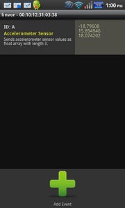

Step 1: Amarino
Here's my amarino code if you wanted to take a look. Don't laugh, please just give me some constructive criticism.
I'm using a rooted HTC inspire.
go to http://www.amarino-toolkit.net/index.php/download.html for more info.
I was experimenting with the switch case to try and get faster response times. do what ever you want. there used to be an if statement there.
I actually modified somebody's code off the internet, so some things seem arbitrary. (I hope I didn't use that word wrong..)
Your going to have to download the Amarino library for the Arduino IDE off their website.

void phoneorient(byte flag, byte numOfValues)
//Phone Orientation Controller
int values[]={0,0,0};
meetAndroid.getIntValues(values);
// You must hold phone in LANDSCAPE for following orientation.
double x=values[1]; //store x as a double (long decimal number)
int y=values[2];
int z=values[3];
