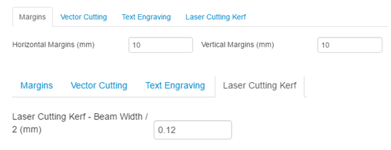

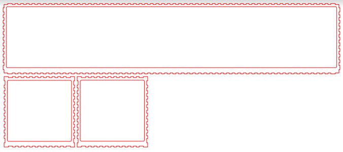

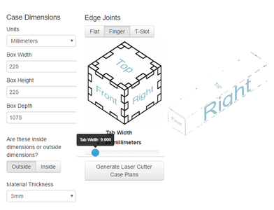

First use the website: http://www.makercase.com/ and use the settings described in picture one. Then press the "Generate Laser Cutter Case Plans" button. Then use the settings described in picture two.
Step 33: Create a Wooden "box" - Step 2

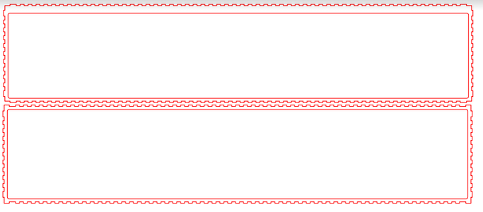

Use Adobe Illustrator (or equivalent program) to draw rounded rectangles inside the pieces of the box you need, remove one of the sides of the box so you have 5 parts; 3 long pieces and 2 square ones. the distance from the rectangle to the outer edge is 10mm on the top and sides, but 20mm in the bottom.
Step 34: Create a Wooden "box" - Step 3
Choose the cut through feature on your laser printer, and send the file to print. Use the 3mm wooden plate preset for the printer and click start. Then wait for the machine to cut out the pieces. Finally identify the pieces and assemble the "box".
