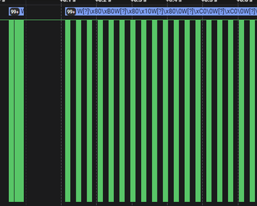

After opening Logic 2 software for logic analyzers, I started the capture, and I started the rangefinder. It seems we're in luck, I2C is the protocol that the screen uses to receive information.
SDA pin of I2C is pin 10 from the ribbon cable connector, and pin 11 is SCL.
In this capture, the rangefinder is started, and then 2 measurements are taken.
While searching for data about the ICs again, I stumbled upon this github repo: https://github.com/pavel-rybnicek/esphome-parkside-plem-50-c3. Pavel Rybnicek already did a reverse on this model, but I discovered it too late. At least, I can gather some data from his findings.
We can see that from the data, the MCU is talking to the screen, sending it data for it to update. We cannot sniff only the measurements, we need to understand what's being sent, and how.

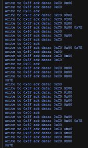

In the third photo there is the second meeasurement being taken. The MCU updates the screen for 110ms, then sends it continously some data, as Pavel Rybnicek says, it is updating the screen only. The MCU sends to 0x3F I2C address, the screen, data to update it's segments, and the screen sends data to 0x60, the MCU.
The data can be converted to decimal, ASCII or hex, but ultimately, we need to black-box test it using some known measurements.
Thanks to the github repo of Pavel Rybnicek, I could decode the data in the I2C packets. In the picture above, there are packets starting with 0xc0. The packets have another byte, trailing the 0xc0 byte. In this case, my measurement is "5.568". The digits are decoded from the trailing bytes, concatenating the two in one. In the github repo there is a decodification function we can reuse to understand what's happening:

The first digit "5" is composed of 141a, ".6" is 1e1a, "5" is repeated, then "8" is 1613.
