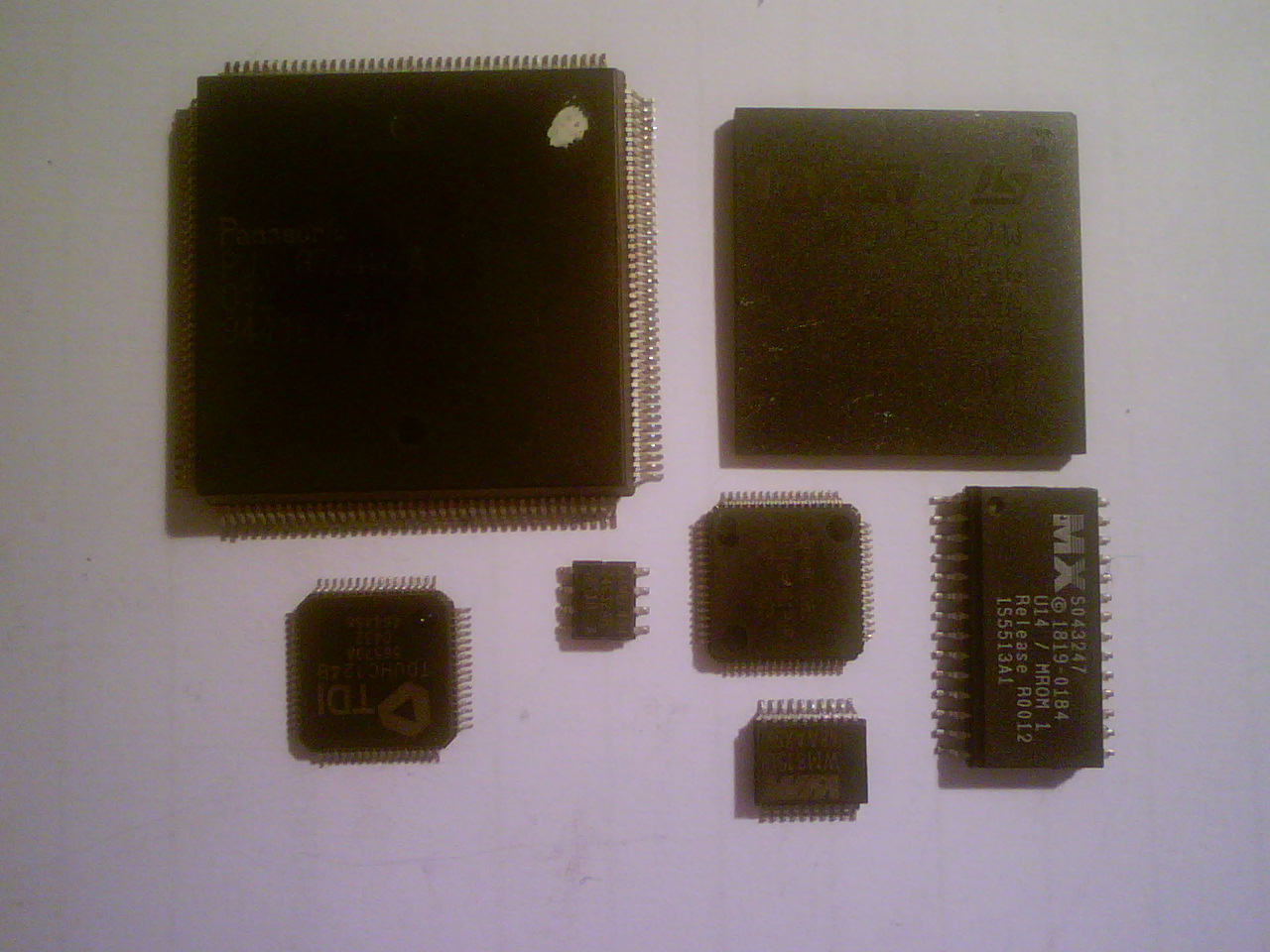

Step 1: Getting Familiar With It
So in order to emulate the ink cartridges, I need to know how they work first. Luckily the ink cartridges in my printer have simple EEPROMs that hold the ink usage and other important information about the ink cartridge such as the expiration date, colour, serial number and so on.
Inside the print head, there is a circuit board with pads mapped out that are an exact mirror of the pads on the ink cartridges and a ribbon cable that connects this board up to the main board on pins 1 to 6.
A quick look at the schematic for the main board reveals that pins 1 – 6 are named CVDD, CSDA, CRST, GND, CSCK and COI.
With these signal names I decided it would be best to draw out a schematic of the connecting board as it was not present in the service manual. This revealed that CSDA, CSCK, CRST have 100KOhm Pull-Down resistors, a bit unusual in my opinion as it’s not like I2C (uses Pull-Up Resistors typically 1.8KOhms to 47KOhms). The COI signal connects serially to the ink cartridges but on the end is shorted to GND. Curiously I tested the continuity of the pads on the ink cartridges and found that they are shorted, this means that when COI is grounded, all ink cartridges are present.
