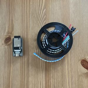

ESP32-WROVER microcontroller
58-LED strip with WS2812B chip

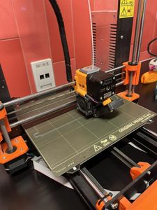

  1. Design the clock case in Fusion 360, ensuring it fits within your 3D printer's build volume.
  2. Print the case in parts using a Prusa MK3 3D printer with transparent white PLA filament.
  3. Assemble the printed parts into a single clock case.
We added a row for mounting the top cap and created space at the bottom for the circuits and plug. The modular design allows each section to fit into the next, making the frame expandable or reducible.
We initially considered shaded glass or plexiglass but anticipated rattling issues. Instead, we designed an integrated body and cap with a hashed front view and printed it using white transparent filament.

  1. Insert the LED strip into the clock case.
  2. Pass the wires through the holes to the back of the clock.
  3. Solder the wires to the ESP32 microcontroller.
Initially, we considered discrete LEDs, but this limited design options. Instead, we found a WS2812B LED strip on Amazon, controllable with a data wire and two power wires.
For power, we used a 5V 2A Apple adapter and a microUSB2 cable. We powered the LED strip directly from the development board, though a future upgrade could include a voltage regulator for consistency with different LED lengths.
