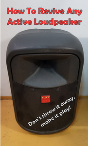

A while ago, a friend of mine gave me an old, broken active speaker. It could still power up, but only some weird noises came out of it. Electronics was completely dead, but the speaker drivers were working just fine. I decided to fix it myself, but where to start? I couldn’t find any instructions on how to replace the amplifier with a different one … which is understandable, because it is usually not a preferable way to do it. Most of the time, damaged electronics can be replaced or repaired but that requires quite some skill (and sometimes a deep pocket). I didn’t want to spend too much money, but I didn’t want to throw away perfectly good speaker drivers either.
I am writing this instructable merely to give a possible idea how to repair the speaker rather than throwing it away. I will try to provide as general instructions as I can, so you have a place to start no matter what kind of a speaker system you have.
My aim is to show you some basics on how to “revive” a speaker yourself. With the term “revive” I want to say, that I am not going to explain how to fix the broken amplifier circuit or power supply unit, but instead how to replace it with (possibly) a cheap new one. We will also have to design our own crossover circuit which will split the sounds from a music source and provide the best output for a specific speaker driver.
You could also use this instructable if you are building a new speaker and would like to learn more about active crossover circuits.
This is a relatively cheap fix, but not preferable one if you have professional speaker system. I advise you that you follow this instruction only if you are certain that the speaker circuit is dead and not even a professional could fix it. Many times, only a fragment of a circuit is not working and if you are able to locate it and replace it, I recommend you to fix it that way.
We will try to replace an electronic circuit, which was specially designed for these specific speaker drivers. Substituting it with a new one is a very hard thing to do. But in my opinion, it is still better to lose a bit of the sound quality than throwing the speaker into garbage and buying a new one. If you put some effort into it, you can maybe achieve the same quality as when they were new.
This will not be a straight-forward process, so some basic knowledge in electrical engineering is desirable. If you have never dealt with electronics before, you should ask someone who has for help. But do not get discouraged…you can try and learn many new things along the way (like many of us did) ;)
