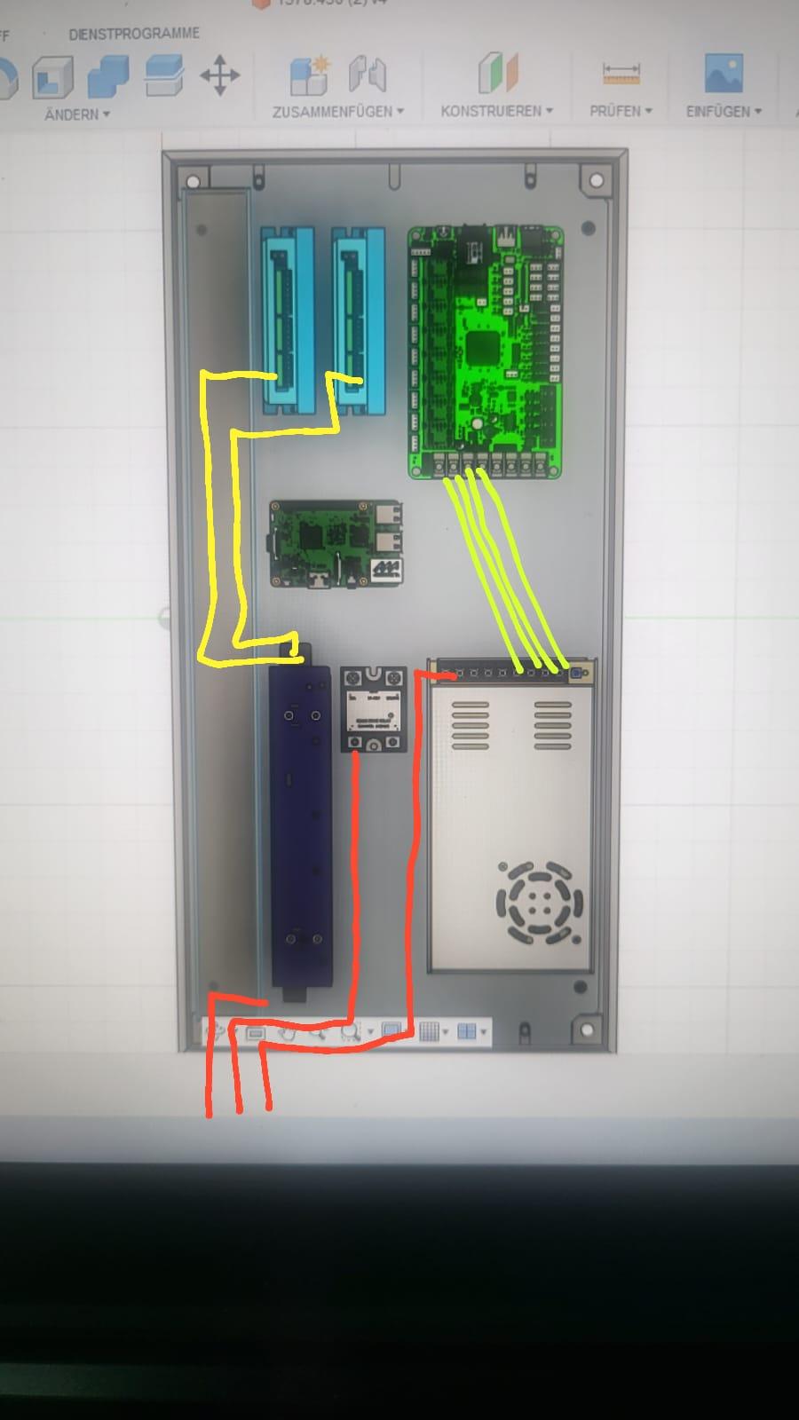

Step 5: First Electrical Draft
After finishing the mechanical installation I started with the planning of the electrical setup.
For my first draft, I took another close look at all the components and thought about how each component needed to be connected and which power supply each component required.
Essentially, there were four separate circuits for the different components:
1) 12V for the fans in the electronics housing
2) 24V for the BigTreeTech Octopus board and everything connected to it
3) 36V for the HBS57 closed-loop stepper motor
4) 230V for the heating bed, which is switched via a solid-state relay
Then I thought about the general wiring of the individual components:
- The Raspberry Pi is powered via the mainboard and also requires a USB connection to control the mainboard
- The display is connected directly to the Raspberry Pi.
- All other components are connected to the mainboard, including the HBS57, the four Nema 23s of the Z-axes, the extruder, the hot end, the BLTouch, the fan for the hot end and the part cooling fan, the end stops, and all others.
All electronic components should be housed in a control cabinet.
To make planning easier, I created a sketch in Fusion 360 and tried to arrange the individual components so that the cabling could be as neat as possible. In the images above you can clearly see the evolving steps.

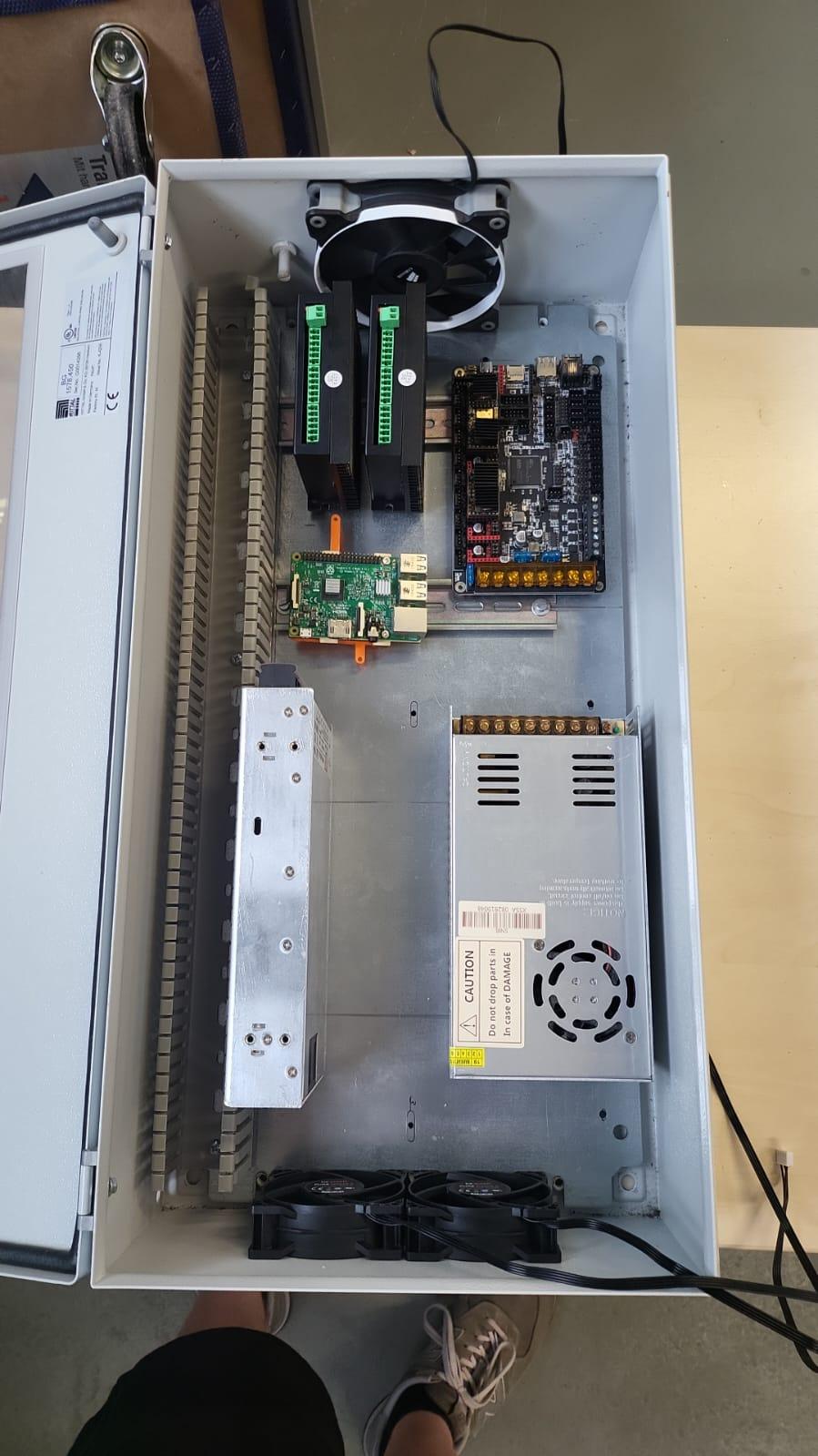

Step 6: Wiring and Installation
After finishing my first draft I started adding the individual components into the control cabinet. After fixing everything in place, I started adding power to all the components, as listet in Step 5.
Afterwards I started conncting the individuall components. To connect the HBS57 to the mainboard, which needed Step / Direction/ Enable and GND, I design a custom pcb for the stepper driver footprint, to allow an easy and secure connection. I then connected the four different Z-Stepper to the corresponding plug, connected the extruder, the BLTouch, the thermistor and heater cardridge of the hotend, the hotend-fan and the part-cooling-fan aswell as the endstops for X and Y axis.
I've uploaded an image of the wiring plan for better understanding.

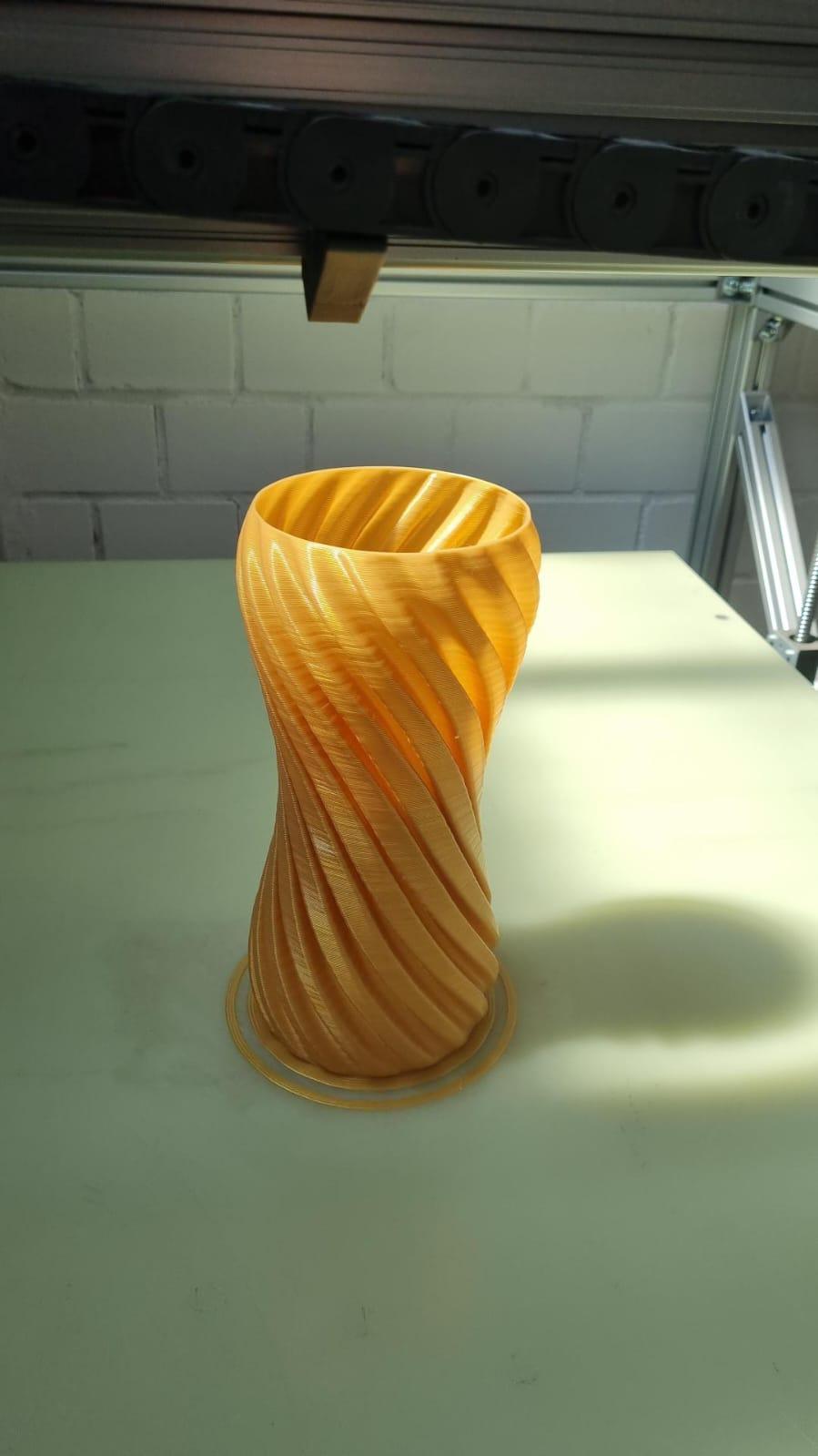

Step 10: First Print
With my fresh created SuperSlicer profile I prepared my first print. Like every other 3D Nerd I started with an 3D-Benchy. As you can see in the images, it did not go as planned. The Z-offset was calibrated a little to high, so that my prints started getting loose mid print. Besides the bad bed adhesion I also noticed that the part cooling fan was way to weak to cool this amount of material in an acceptable time.
Step 11: Improvements & First Successful Print
After the first round of tests it was clear where the weak links were: my Z-offset was set a touch too high, the part-cooling system couldn’t remove heat fast enough for a 1.4 mm nozzle, and the uneven bed still showed through on wide first layers. I tackled the three items in that order and then re-ran the same print.
I began with the Z-offset. With the bed heated to first-layer temperature, I homed, moved to the center, and inched the nozzle down on a plain sheet to the point where a strip of paper could just about drag. I saved the new offset and immediately ran QGL again to square the gantry. Because this machine’s bed is mechanically uneven, I also tightened the bed mesh: I increased the probe density and expanded the probed area to cover the regions where I’d seen early lift. To make the mesh more trustworthy on a large AC plate, I added a short heat-soak in my PRINT_START so the surface settles before probing or printing.
Next I addressed part cooling. The original fan and duct were fine for small nozzles but simply couldn’t keep up with the mass of a 1.4 mm bead. I switched to a higher-flow blower and reworked the duct so the airstream actually meets the strand right after it leaves the nozzle, with a little distance to avoid chilling the block itself.
Finally, I improved first-layer adhesion. On a bed that isn’t perfectly planar, a tiny safety margin helps: I slowed the first layer slightly, kept it thick and wide, and—old but gold—wiped a thin film of PVA glue (glue stick) on the print area. The glue evens out micro-texture and adds a predictable tack that survives long jobs. Together with the denser mesh, this prevented the mid-print de-bonding I’d seen before.
With those changes in place I started a new print and was finally successful!
