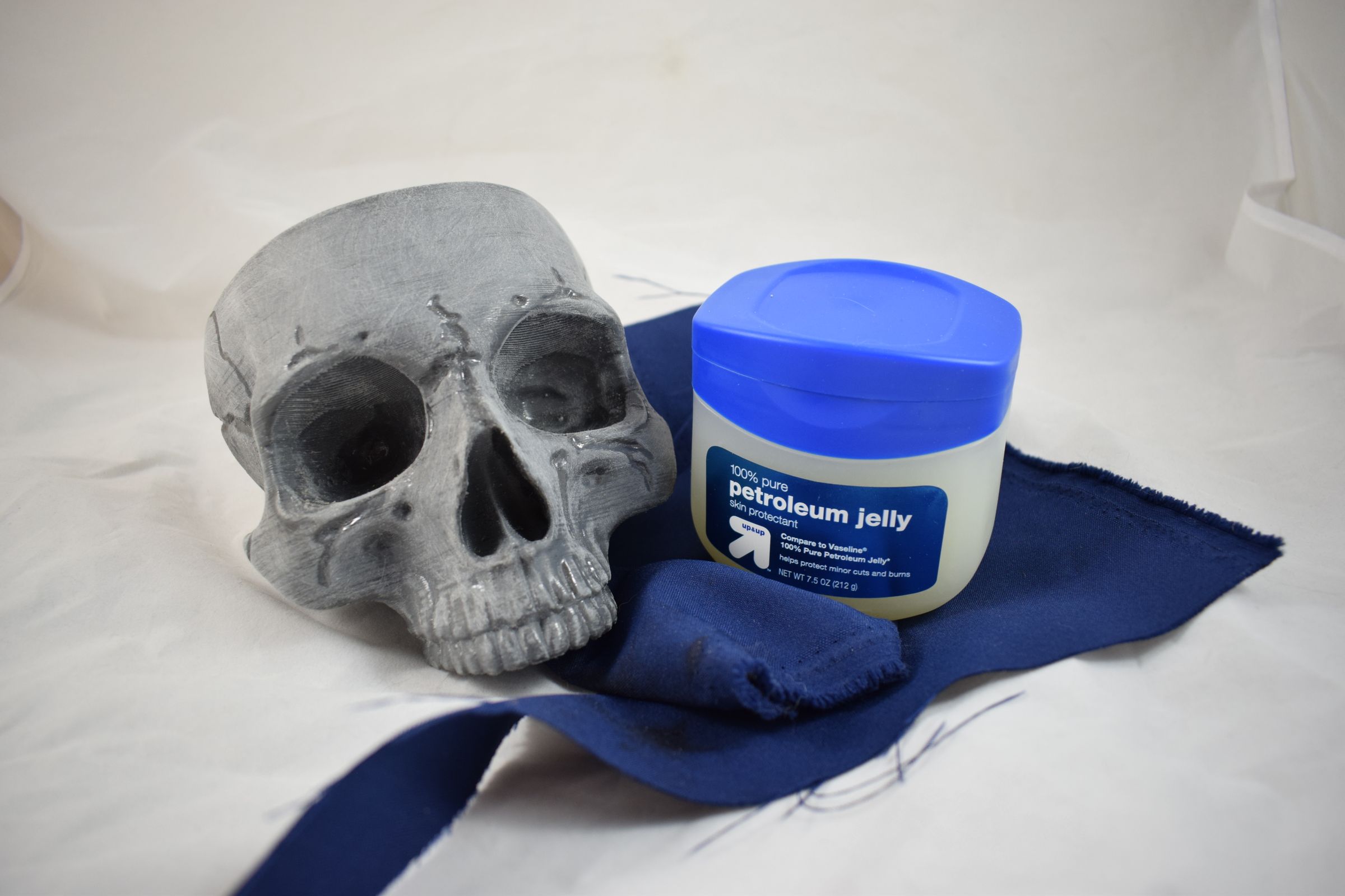

Requirements:
- A pre-sanded 3D printed design.
- Cloth or towel.
- Container of Petroleum Jelly or Vaseline.
Step 1: Restoring the Color
- If you have not, sand down your printed piece(s). Grit doesn't matter. I personally will start with a 60 grit and work my way up to a 300 grit. You can either wet sand or dry sand the pieces but allow wet sanded pieces to dry completely before proceeding with the polish method.
- Once your printed pieces are prepped, cover the sanded areas with a medium coat of petroleum jelly and rub into the plastic with a cloth or towel. Let it sit for 24 hours. Wipe away any excess with a clean cloth and rub what remains into the plastic.And that's it! The petroleum jelly penetrates the plastic to reinvigorate and create a lasting color. Clear coat gloss spray can be applied later on afterwards if desired to give the print some shine.
