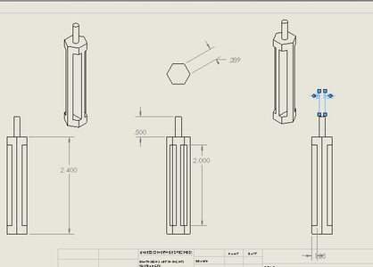

Step 1: Modeling the Part

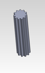

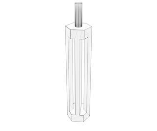

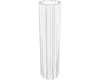

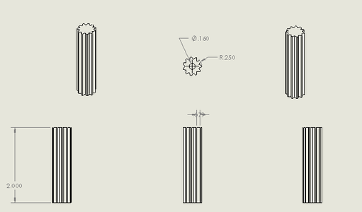

I used the horrible program of SolidWorks to make this part. It was really hard and unhelpful because it is a terrible program. I first made it and then I printed it out on a old crappy Makerbot. I have included pictures of the dimensions and such but I will also include a file download for this step.

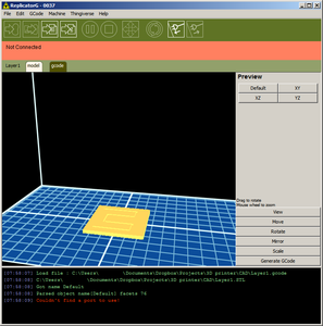

Step 2: Printing the Part
Next I loaded the program onto the ReplicatorG program for the Makerbot. I made sure to center it and put it on the platform. You can do this by going to the move tab and clicking center and put on platform.Next I made sure that the part was on the flat hexagonal end
with no hole or peg. This will allow it to print without problems. The image below is not my part, it is just an example of what ReplicatorG looks like.

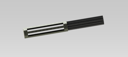

First, take the part with the two slots and look at the peg. Then take the other part (the handle) and examine the hole. Put a little bit of blue into the hole. The put some glue all over the peg. Insert the peg into the hole. Allow time to dry.
