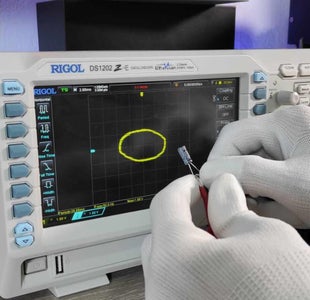

Step 6: Testing and Validation
Before putting our circuit to the test, we conduct thorough voltage measurements to validate functionality and safety. With confidence in our design, we connect the Octopus to the oscilloscope and begin testing various electronic components. Through meticulous observation and analysis, we gain insights into component behavior and circuit performance, honing our troubleshooting skills along the way.

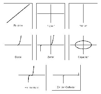

During testing, interpreting the displayed curve is key. A resistor manifests as an oblique line, while a short circuit appears vertical, and an open circuit horizontal. Capacitors form circular curves, with size indicating capacitance. This visual guide swiftly identifies component health.
