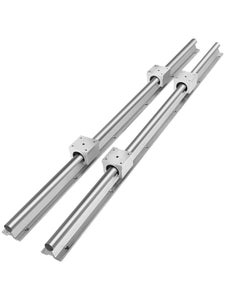

Step 3: Connect the Rails to Frame
I used 6 mm x 15 mm screws to attach the sliding rails to the frame. I used a SBR20 type linear rail.

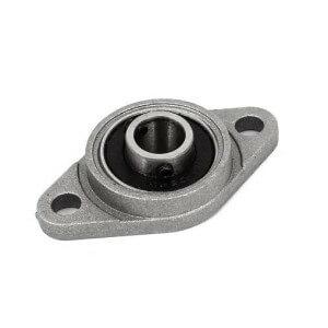

To connect the Screw thread to the frame you can use bearing block house.

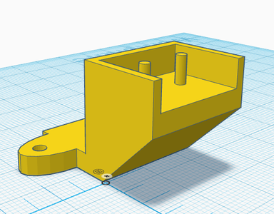

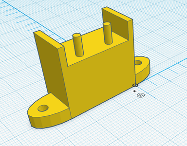

The limit switch holders are designed in Tinkercad and printed by a 3D printer. As the GRBL documentation suggests, I used Normally-Closed (NC) wiring for limit switches.

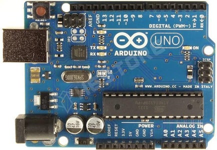

To control the motors through G-code, I use a program called GRBL uploaded onto an Arduino Uno board. The Arduino controls the stepper motors via DM542 breakout boards.

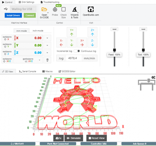

I use a 3 mm plywood for processing the image designed as an SVG vector graphic, which can be converted into machine-readable G-code using the OpenBuilds CONTROL program. OpenBuilds CONTROL is an application for connecting to, and controlling, your CNC, Laser, Plasma or Dragknife machine.

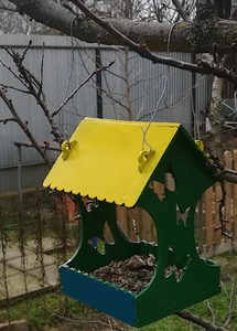

In this section you can see the first attempts with my brand new CNC milling machine. One of my first works was machining a simple heart shape from 3 mm plywood. Then I made a bird feeder from several pieces, which has been happily serving hungry birds in my garden since. Additionally, with the help of the machine, I also created a two-piece tulip made of plywood.
