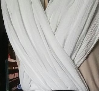

Body Wrap: White Cotton Bubble Gauze (5 yrds)

The next dye bath was for my wrap material (bubble gauze) and I chose to go with the black tea bath in the stainless kitchen sink. I made 3 gallons of super strong black tea (Twinings English Breakfast Tea, loose leaf) and used almost all of my brand new 3.53 ounce tin. I then rinsed and wrung out my fabric and added it to the sink with the tea bath. It soaked for about 15 minutes total then I tested it with a cool water rinse on a small portion of the fabric and was happy with the results. I then repeated the steps, as above, for rising and wringing until the water ran clear. I then hung it up on 2 hangers (it was 5.5 feet of fabric) and let it dry on my balcony.
