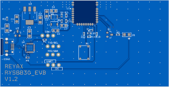

The evaluation board has jumpers for UART or I2C Interface. It also has a reset button for resetting the board or restarting the module. The board consists of a CP2102 Chip which is a USB-UART Driver chip. The micro-USB port can be used to connect the module directly to the computer and also the GNNS Software.

Step 7: PCB Layout of RYS8830:
Circuit diagram is provided below with RYS8830 PDF. So, you may change the alignment, color and specifications of your PCB accordingly. Here in the circuit cp2102 USB TO Serial chip can be changed to some cheap solution like CH340G or FTDI232RL. Finally it's Depend on you and if you want to use same design then Download Gerber files from here.

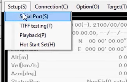

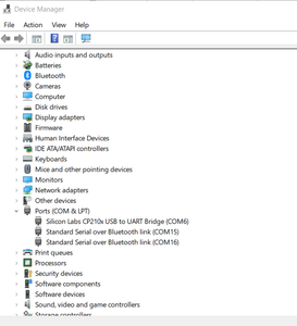

1. Click on “Setup(S)” in the GNSS Monitor software
2. Click on “Serial Port(S)”; A new dialog “Serial Port” pops up, correct serial poet can be seen in Device manager of your PC.

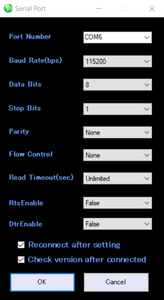

3. Now enter the following settings as shown in the image below
4. At last click on the OK button and a serial connection to the RY8830_EVB will be established

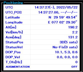

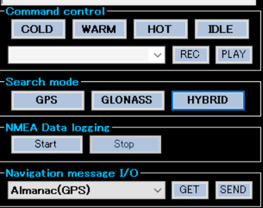

  • Since the RYS8830 module on the evaluation board is turned on for the first time, the cold start (COLD) should be pressed. When pressed, a signal is sent to the module and it starts to lock onto some satellites. You should see some log messages and list of satellites. After some minutes, the GNSS Monitor should show the current time and position in the upper left window:
