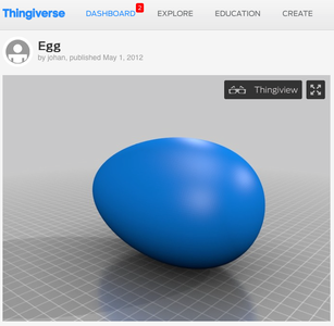

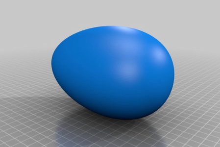

Download a 3D .stl file for an egg. There is one on Thingiverse here that works nicely. Thank you Johan for uploading it!
The egg is very large so it needs to be reduced in size. It is oriented horizontally which is not ideal for 3D printing so it needs to be rotated. It is solid, so it also needs to be hollowed out.

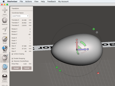

I went into Meshmixter to the left hand menu and selected Edit and then Transform in order to rotate the egg. You can rotate the egg so it is point-up or point-down. I found whatever end is on the build plate gets a flat spot. If the point is up the large end's curvature approaches the limit of unsupported 3D printing and may have some surface anomalies or issues printing. So you can decide on which orientation to print the egg in. I have printed in both point-up and point-down and each has merits. I kind of like the smooth point so I like to print point up.

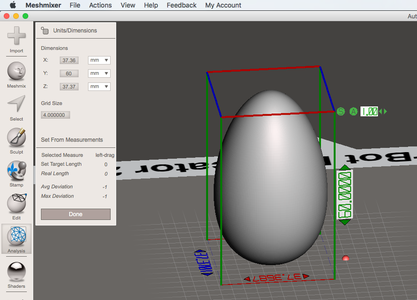

The large egg needs to be brought down to a nice small size and I went into Meshmixer Analysis then Units/Dimensions which allow you to enter a specific numeric size. I made the egg 60mm tall, which approximates a real hen egg.

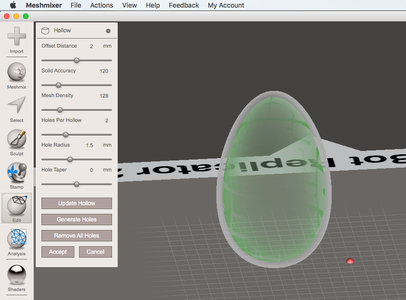

I almost forgot - The egg needs to be HOLLOW! So I went to the Meshmixter Edit menu and selected Hollow and adjusted the sliders to get a 2mm wall thickness. (Alternately you can print the solid egg, but have your slicing software print it with zero infill and control the number of layers that make up the wall thickness. I tired it both ways and I like hollowed out as it provides a more consistent wall thickness. It tends to get a bit 'weird' at the top and bottom when printing with zero fill and only wall thickness layers.)
I then sliced the .stl file with Cura free slicing software to get my final g-code. I have attached .stl files for a 60mm egg with a 2mm wall thickness in both point-up and point-down orientation so you can slice them.
