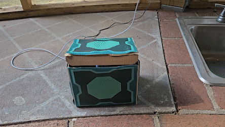

We have the ability to control any device we put together, and an absolutely tragic lack of Meeseeks. It only makes sense that we create a simple smart device for us to control the Meeseeks' box. Custom devices, like the Meeseeks Box, use MQTT for communication, allowing the Flask server to dispatch commands reliably across the smart home setup. The device is a simple Esp8266 with a servo. When we get the command "Halloween 1", it opens. When we get it again, it closes. Rinse and repeat, and you have a cute little party gag.
The arduino code is pretty simple, but one thing that's worth noting is that I changed the topic that the custom devices listen for so that we don't end up in an infinite loop where the server publishes to a topic it's listening to.
