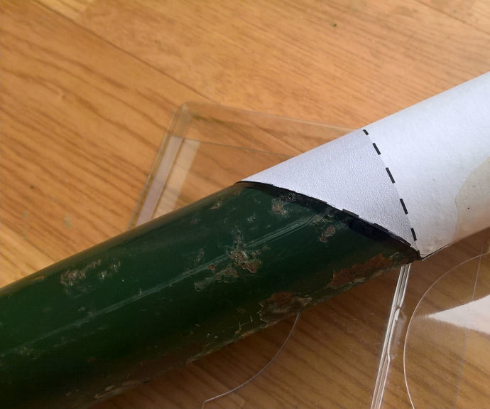

While the body is drying you can go on with the steering column.
Double check pictures to prevent errors.
Prepare the tube and drill two holes of 5 mm diameter, 15 mm from the end and the beginning.
Drill the handlebar, 270 x 30 x 30 in center with a 16mm diameter hole and a 5mm hole wich will block the steering tube. Assemble and screw handle bar with the tube and then pass the assembly in the body.
The work continues underneath, adding a washer and then hubbing the axle. The axle, 180x30x30, is locked identically to the handlebars. The washer makes it possible to rest on a surface limited to the weight of the pivot.
