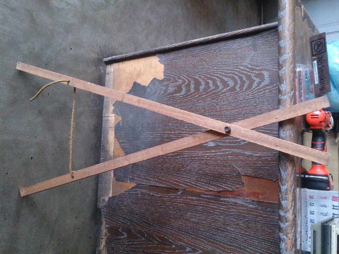

Step 2: Crossing Point
Measure your shoulder level to determine the wood-sticks crossing point. You can make it higher or lower according to your shooting comfort. Drill through both sticks at that point, then put the bolt in. Do not fasten the nut too tight on the stick because that is our moving pivot. That's why we need two nuts. Fasten the second nut to the first nut, this time make it tight.
Step 3: Another Drill
Drill another holes near the other ends of sticks. This is where we put the rope through to limit the opening range.
  • Put the rope through the holes.
  • Make a knot at one end.
  • Define the maximum opening of the sticks.
  • Make a knot at the other end.
Done ... ^_^
