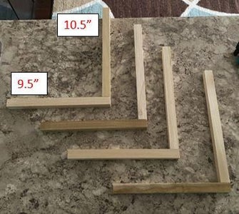

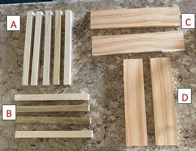

Step 1: Cutting Wood for Stage
Begin by cutting the ¾” x ¾” dowels and 1” x 3” wood to specified lengths listed below. The letters associated with the cuts in the list below ling up with the cut pieces in the picture above. It is recommended to use a hand saw or a miter/circular saw.
Specified Lengths:
A. ¾” x ¾” Dowels: 10.5” (inch) length (Quantity of 5)
B. ¾” x ¾” Dowels: 9.5” (inch) length (Quantity of 4)
C. 1” x 3” Wood: 12” (inch) length (Quantity of 2)
D. 1” x 3” Wood: 10.5” (inch) length (Quantity of 2)

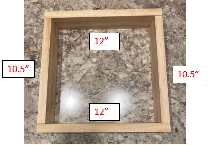

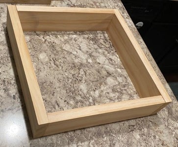

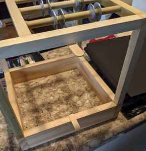

Step 2: Gluing Base of Stage
Use wood glue (or hot glue) to glue together the four 1” x 3” cut pieces as shown in Figure 2 and Figure 3. You will want the top and bottom pieces to be the 1” x 3” x 12” wood pieces, and the left and right pieces to be the 1” x 3” x 10.5” wood pieces.

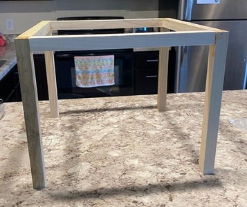

Step 3: Assemble the Top Half of the Stage
Take one ¾ ” x ¾ ” x 9.5” square dowel and glue it to one ¾” x ¾” x 10.5” square dowel. Repeat this step 3 additional times to have a total of 4 assembled arms as shown in the picture to the left.
To assemble the top half of the stage, glue the arm components from one end to another’s joint. Stand two arm components up so that the 9.5" arm is perpendicular to the work surface. Glue the end of the 10.5” length to the left face of the junction on the second arm component. Continue this with all arm components so that the end product is in the shape of a square as shown in the picture to the right.
Step 4: Supporting Beam and Stage Assembly
For the fifth ¾” x ¾” x 10.5” square dowel, glue it 2” from the inside face of one other square dowel. Doing so will indicate the front of the Stage. In addition to the addition of the fifth square dowel, glue the bottom of the legs to the base part of the stage frame.

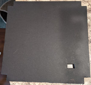

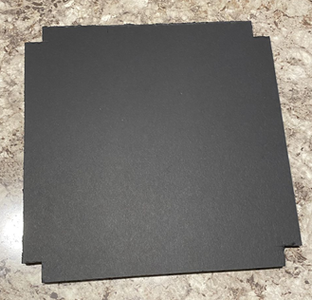

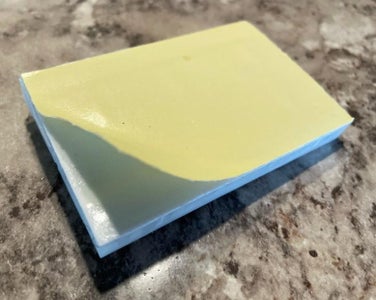

Step 5: Stage Floor
Cut a ¾” x ¾” square on each corner of the foam board.

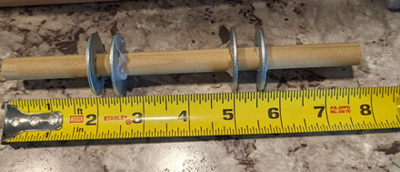

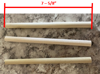

Step 6: Cut Dowels
Cut a quantity of 3 – ¾” dowels to a length of 7 and 5/8 inches.

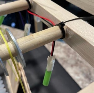

Step 7: Attach Washers
Use hot-glue to attach the washers to the dowels at 4 separate locations. The first washer location will be 2” from the far left end of the dowel. The second washer will be located at 2.5” from the far left end of the dowel. The third washer will be located 5” from the far left end of the dowel. The last washer will be located at 5.5” from the far left end of the dowel. Repeat these locations of the washers on the remaining two dowels.

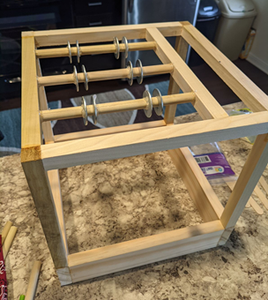

Step 8: Attaching Dowels

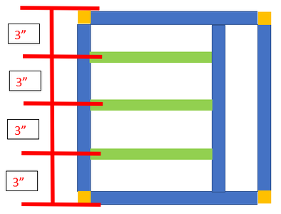

Attach the dowels with hot glue or wood glue at the distances shown below in the picture to the left. At the end of gluing, they should match the picture on the right.
Step 9: Manual Rigging Tie-off Points
Snap a popsicle stick in half and attach one half to the top of the frame. Attach the other half to the bottom of the frame as shown in the picture above. Both halves of the popsicle sticks will be attached in the middle of the stage section on the right side of the stage (when looking at the front of the stage).

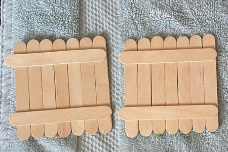

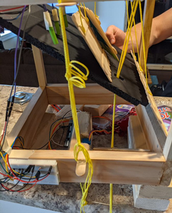

Step 10: Prop Construction
The props that will be rigged on the stage will be constructed out of popsicle sticks. Start by placing 2 popsicle sticks approximately 2.5 inches apart from each other. Glue(wood glue, super glue, or hot glue)popsicle sticks to create a flat layer perpendicular to the first 2 popsicle sticks placed.
Pictured above is the rear of the finished props. The finished dimensions of the small popsicle stick props are approximately 4 ¼ in x 4 ½ in.
Using the same method as used to create the small props before this time by adding more supporting popsicle sticks to the rear of the prop length can be extended. The finished dimension of the large popsicle stick prop is 10 ½ in x 4 ½ in.
On the flat side of both the small props and the large prop you are free to paint, draw, or otherwise create whatever design you wish to be displayed on the finished stage.

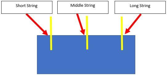

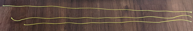

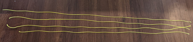

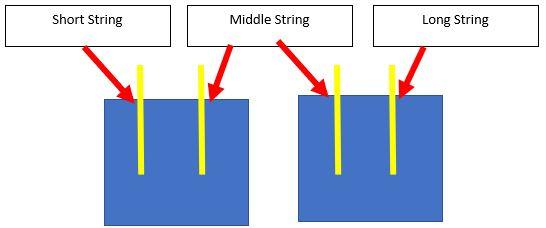

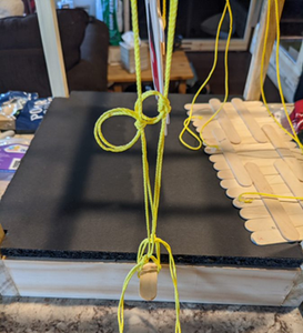

Step 11: Cut String
Cut string to the following dimension: 2- 24”, 3- 21”, 2-18”. The picture of 4 strings above will be used for the smaller props towards the front of the stage and have lengths of 1-24", 2-21", and 2-18". The picture of 3 strings above will be used for the large prop at the rear of the stage and have lengths of 1-24", 1-21", and 2-18".

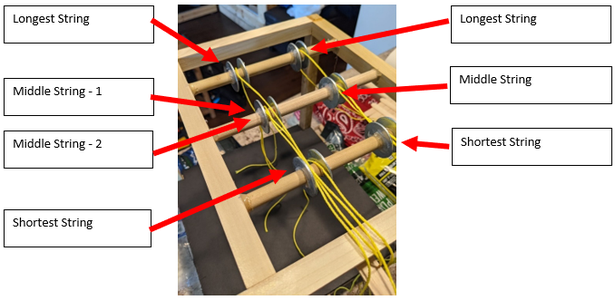

Step 12: Assemble Strings
Drape the stings according to the picture above. The set of 4 strings will be towards the front of the stage and the set of 3 strings will be placed towards the back of the stage.

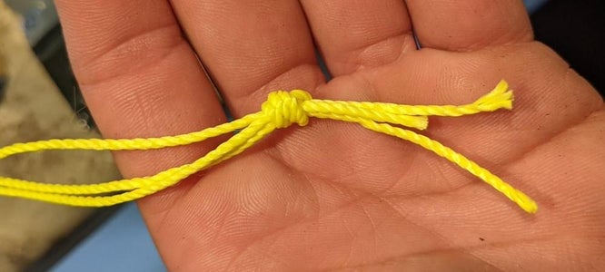

Step 13: String Knotting
Tie a knot at the end of the set of 3 strings. This will later be glued onto the motor shaft for operation of the electrical lifting mechanism.
Tie a knot at the end of the set of 4 strings as described
below:
1 long string + 1 medium string = Tie knot at the end
1 medium string + 1 small string = Tie knot at the end.

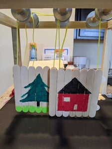

Step 14: Attaching Props
Use hot-glue to attach the other end of the string to the back of the props. Make sure when gluing the strings to the back of the props, that the prop is sitting on the stage and all strings are glued tightly to the prop. Reference the pictures above for the placement of strings.

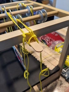

Step 15: Tying Loops
Create 2 loops on each set of tied strings for the SMALL props only. When the prop is at its lowest (touching the base of the stage), create a loop in the string where it will hook onto the top tab that was placed in step 12. When the prop is at its highest (touching the top of the frame), create another loop on the string where it will hook onto the bottom tab that was placed in step 12. Reference the pictures above to understand how these loops will look when hooked onto the tabs at the top/bottom of the stage.

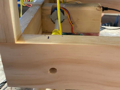

Step 16: Stage Hole
Using a knife cut out a small hole in the back right corner of the stage. This hole should be approximately 1 x ½ in size and 2 in from the back and right side of the stage.
Step 17: Installing Stage
Once the hole for the string is cut, place the string attached to the large prop through the hole.

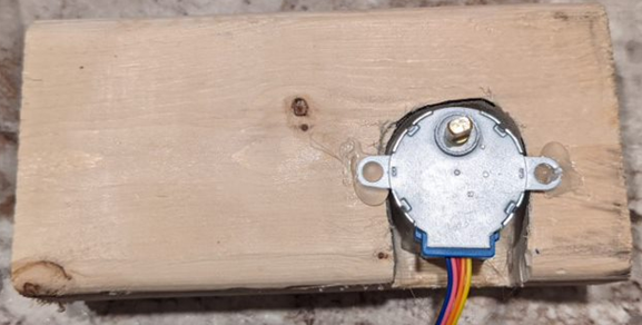

Step 18: Cutting Hole for Motor
Cut a hole for the motor. A Dremel, jigsaw, or other tools could be used to do this.
Step 19: Install Motor
Once the hole has been cut place hot glue on the bottom and on the screw mounts of the motor and place the motor in the hole as shown below.

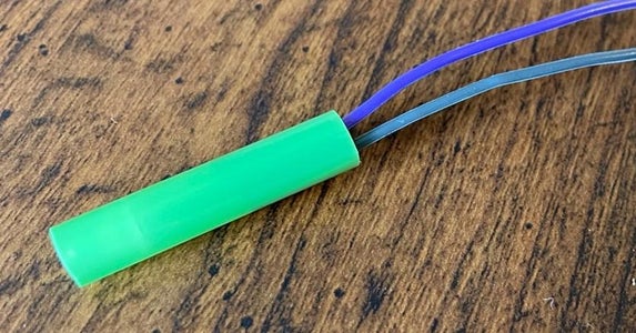

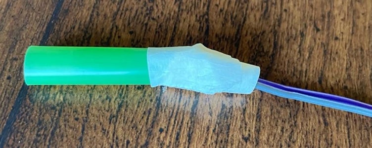

Step 20: Attaching Pen
Take a pen and cut it to the length of 5”. Make sure that the pen casing can sit on the shaft of the motor when attaching.
Drill 19/64” bit hole onto side, in line with motor shaft.
Shove pen casing through the hole to the shaft. Glue the pen onto the motor shaft with hot glue.
Step 21: Attach String
Place the string for the large prop onto the pen casing and glue it ½”- ¾” from the face of the motor.

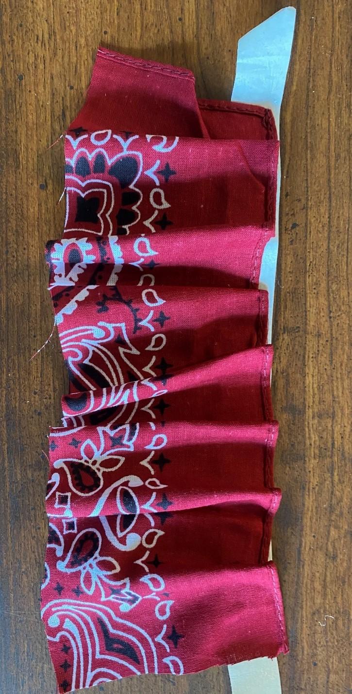

Step 22: Cutting Curtains
To conceal wiring and make the stage look more like a real stage, a bandana will be used to create side and top curtains. The figure below shows the cut-to-size side curtain. You will need to cut 2 side curtains. The dimensions for the side curtains are 11 in x 5 in. You only need to cut 1 top curtain. The dimensions for the top curtain are 13 in x 3 in.
Step 23: Forming Curtains
The 2 figures below show the folded curtains. To add more detail to your curtains you can add folds to create a textured curtain. Place tape on a flat surface and fold the curtain over itself.
Step 24: Attach Curtains
Attach the curtains to the stage. Glue the curtains to the top of the stage as pictured in the figure above.

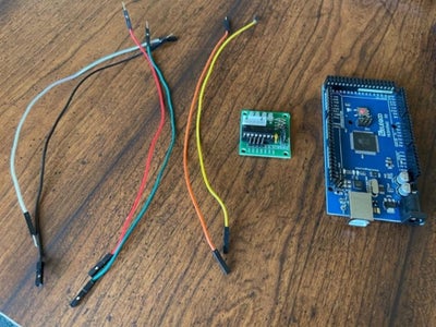

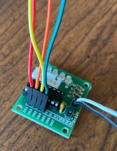

Step 27: Collect Wiring Items
Next is connecting the stepper motor driver board. To help with this I’m using an individual color for each connection. Each wire here is a male to female wire. (Male is an end with a small metal pole, female is an end with a hole)
Step 28: Connect Stepper Driver
To setup the board connect the female end of the red wire to IN1, orange to IN2, yellow to IN3, green to IN4. The wires should be in the order of a rainbow for easy keeping track. The female end of the black wire should go above the negative(-) terminal at the bottom of the board while the white should go next to it on the positive(+) terminal.

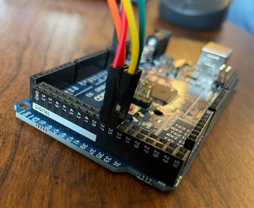

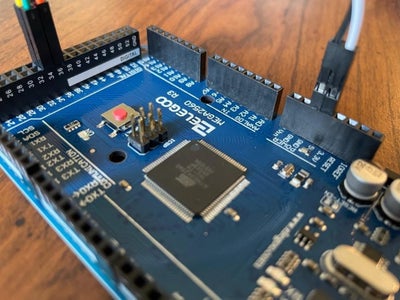

Step 29: Wire Microcontroller
The male ends are all going to go into the microcontroller ports. On the side of the terminals you’ll see a pin number. The red wire goes to pin 37, orange goes to pin 36, yellow goes to pin 35, and green goes to pin 34. The black wire goes to any pin labelled GND and the white goes to any pin labelled 5V, I put them along the side rail to keep them together.

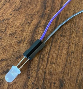

Step 31: Fabricate Lighting Components
For this step grab tape, 2 wires (I suggest a dull color and a bright color), an LED, and a plastic straw. Cut the straw to a segment that’s about an inch or so long, the length doesn’t matter too much just don’t make it too long.
Step 32: Assemble Lights
Take the bright wire and plug the female end into the long end of the LED and then put the dull colored wire into the short end. Then put this combination into the straw making sure the connections don’t come undone in the process. Lastly wrap the end in tape to keep the wires and straw in place, do the previous process 2 more times to make 3 lights in total.

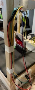

Step 35: Cable Management
Once the LEDS are wired to the breadboard tape the wires down to the vertical beam next to the breadboard. This will keep them organized and in one place, aswell as not ruin the image of the stage having wires everywhere.

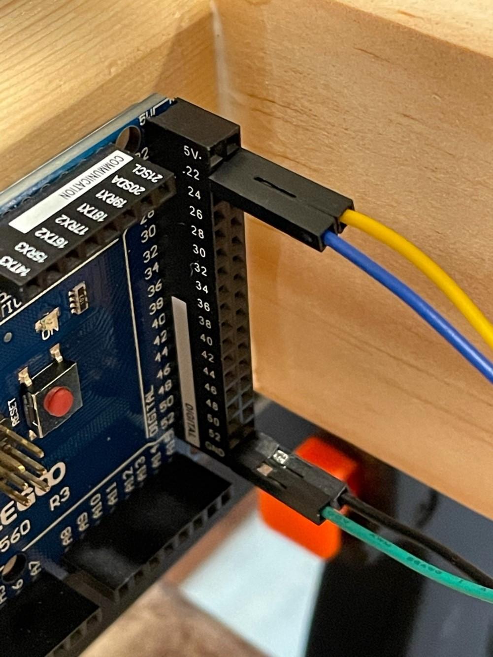

Step 37: Push Button Microntroller Wiring
The bright color wire going from the left pushbutton goes to pin 22 while the other bright wire from the right pushbutton goes to pin 23. (The stepper motor connections were removed for visibility in this picture but keep them in for your design)

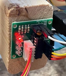

Step 41: Attaching Stepper Motor Driver
Last step for the electrical components is to hot glue the stepper motor driver board to end of the wood block you attached the microcontroller and motor to.

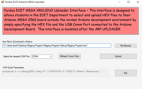

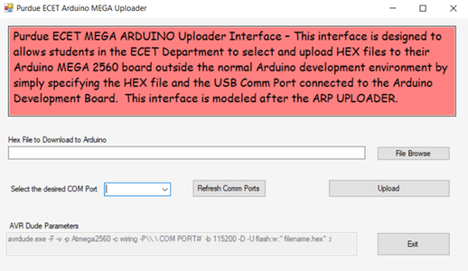

Step 43: Setting Up Uploader
On the other end connect the USB into your computer and download the .zip file attached to this step, the link is below. Double click the zip file to unzip it. Run the Purdue ECET MEGA Arduino Uploader.exe. The uploader is pictured above.
Step 44: Uploading Code
Next click the drop down on the COM Port and select the first port that shows up. Also click “File Browse” and navigate to the unzipped folder and select “Rigging Program.hex”. The uploader with the program loaded should look like the picture above.
Click upload. If an error occurs try the next COM port if there’s more than 1. If that doesn’t work make sure you’ve selected the right file. If it went through with no errors test the pushbuttons on the breadboard. The motor should turn in both directions and the lights should be on.
