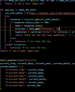

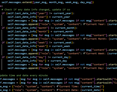

To get the code rolling, start by setting up all the necessary imports, then plug in your Groq API Key. Once that’s locked in, instead of juggling a bunch of if-else statements, you’ll send the data straight to the API. And yeah, this AI can handle multiple queries at once—multitasking like a pro. If you wanna get extra slick, you can add a backup API Key and a private AI setup like I mentioned earlier. But honestly, you only need those backups if you’re throwing way too much data at it—otherwise, you’re good without replacements or private setups.
Now, onto the logic: set up your API Key and pick your favorite model like LLaMA 2, LLaMA 3.2, whatever you vibe with. Then make it answer questions. But don’t get cocky, we ain’t done yet. You can level it up by adding weather and news API keys and feed that info into the main API. Pro tip: in the personality instructions, tell it not to spill the info unless explicitly asked. That way, it’s chill and not oversharing.
For example, what I feed to Rika is the whole shebang: Time, Date, Year, Month, Week, Day, News, and Weather—plus those personality instructions that keep her smooth and human-like. Boom, that’s the magic sauce.

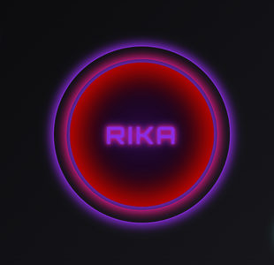

Step 2: UI
For the UI, honestly, you’ve got full creative freedom—design it however you want because, well, it’s your UI. Make it slick, simple, flashy, or old-school retro vibes; just make sure it works and looks dope for the user. No limits, just pure style and function. I'll show you mine.
