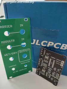

Step 2: The Module and BOM

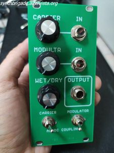

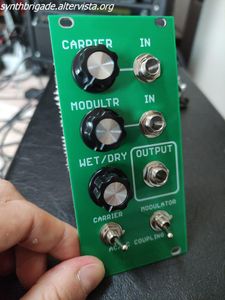

The module I have layed down provide two 1/4" jacks connectors where to feed carrier and modulator signals, with control over intensity via two potentiometers in voltage divider configuration.
The relative intensity of dry (modulator) and wet (amplitude modulated carrier) signals can be tuned via the dedicated WET/DRY potentiometer.

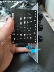

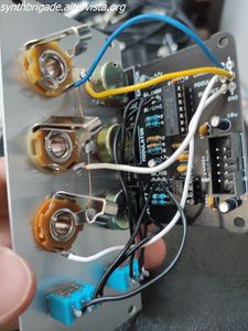

The PCB board is intended to be mounted perpendicular to the face plate aluminum board.
Gerber files of both PCB's are stored HERE (Github). You can have them manufactured HERE (JLCPCB, affiliated).
Disclaimer: I often confuse carrier and modulator. It makes more sense to me to think at the first as the main signal source and the other to the modulating wave, but looks like it's not the case. My prototipe (the one pictured in this instructable) was reversed. Even if it's only a matter of labelling, this issue is fixed in the shared files.
Please notice that face plate holes are dimensioned for 1/4" jack connectors, not eurorack standard 1/8" connectors. You can eventually download blank faceplate files at THIS link (Github). Included are boards source files (.brd) so that you can laydown appropriately dimensioned holes and silkscreens where you prefer, as a function of your module idea.
