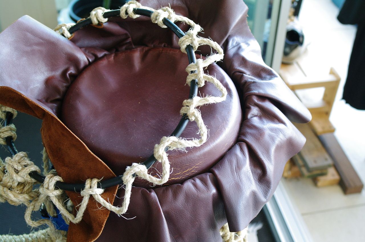

The stuff I build requires me to make ring of round and square bar of 10 or 12mm. Before making this roller, I used a different jig that was way too ineffective. Now, I can easily make all diameters of rings, as small as 12cm.
