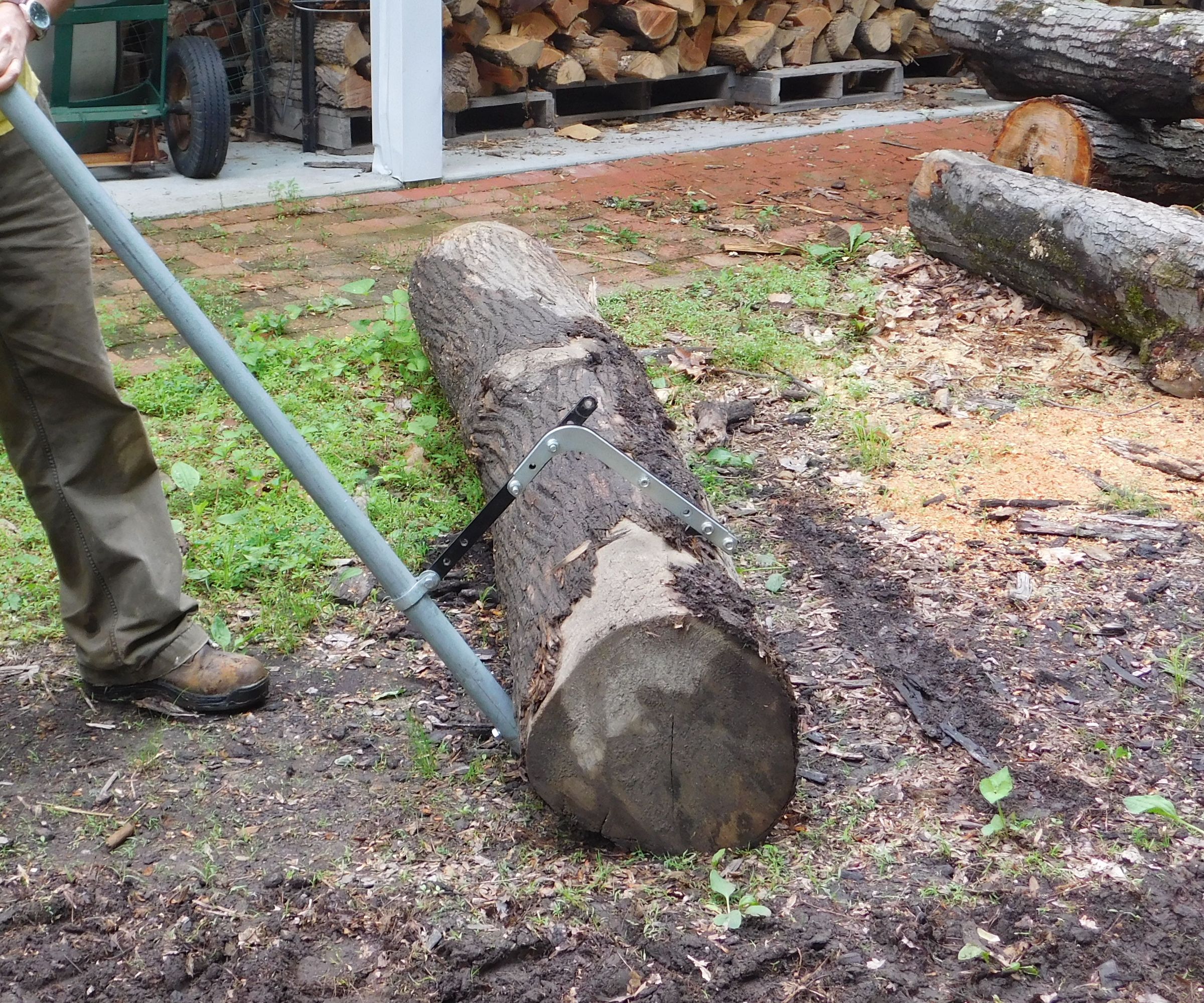

I am into re-use and re-purpose. This instructable is the first in a series using parts from garage doors. Others projects will include wireless timed-limit lights, a log roller, wall hooks, a fidget, ...
