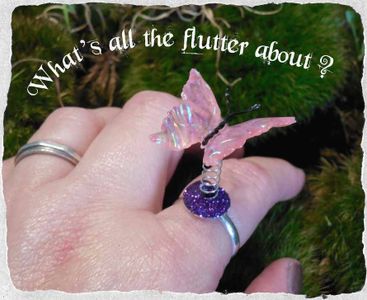

Step 4: Adding Spring to Your Ring!
Remove the spring from the empty pen; you may want to cut it down. I left mine long.
Put a little dot of the acrylic resin on the back center of your shape, wipe your brush off, be quick, now press the spring into the dot, and hold for a minute. Do the same thing to the ring form; this one is adjustable so my granddaughter can wear it.
Roll up some foil and slide on the ring form, this will hold it steady while you work, add a dot of acrylic to the top of ring, clean the brush, and once again be quick and set the butterfly spring into the resin.
Add more resin and while it it wet sprinkle on glitter; give a little pressing with your finger to set the glitter.
If you want antennas on the butterfly just fold and twist the 30-gauge wire, like photo, glue into place with super glue. If you will be doubling up your butterflies then add the other butterfly first then glue on antenna body.
That's it, you created a ring with spring.
