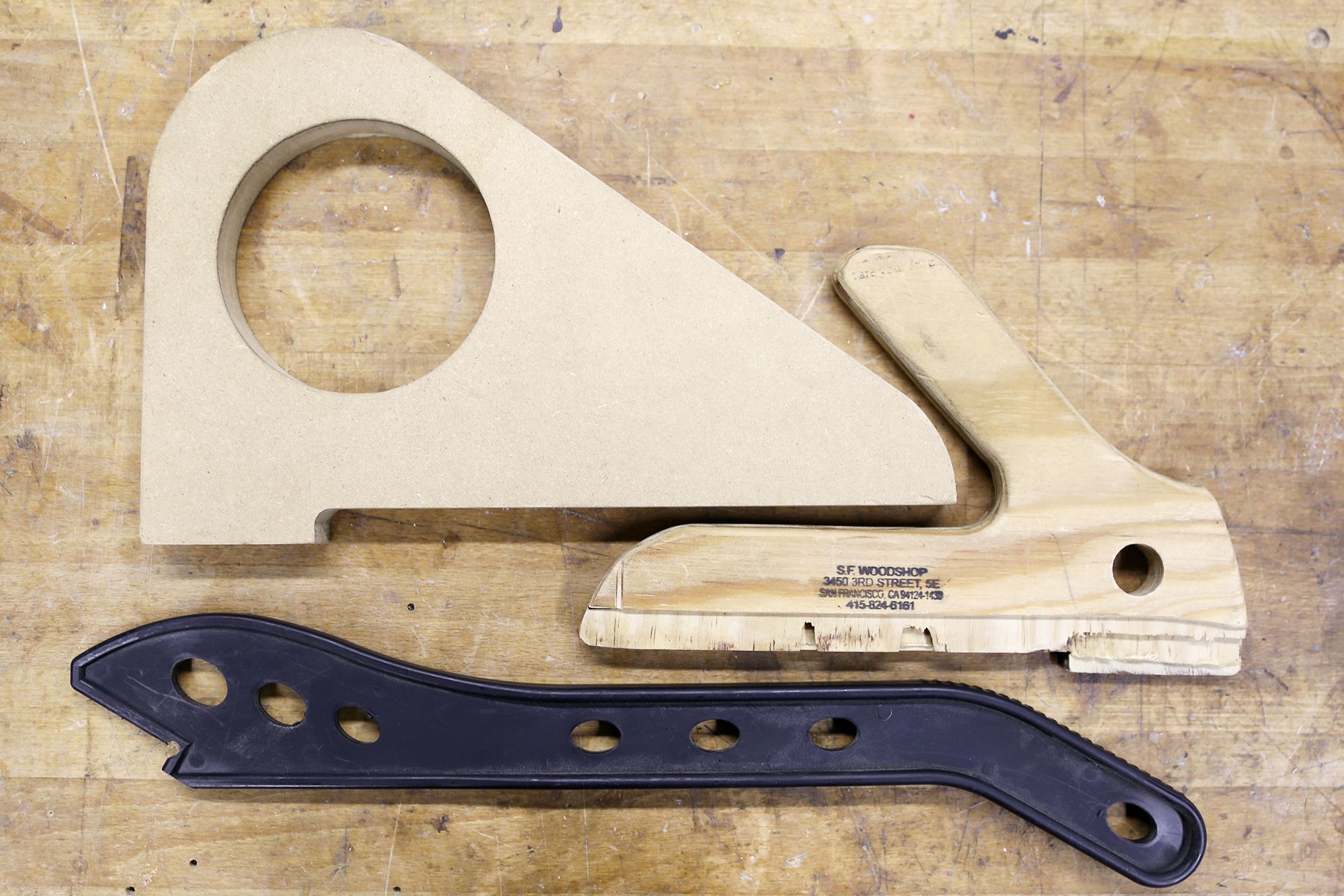

The table saw is a powerful machine and safety should be taken very seriously: Kickback or accidentally losing a finger to the blade can happen so fast that not even Neo from The Matrix could get out of the way fast enough. Always use eye protection, always roll up loose clothing and tie back long hair, and always use push sticks to feed material through the blade.

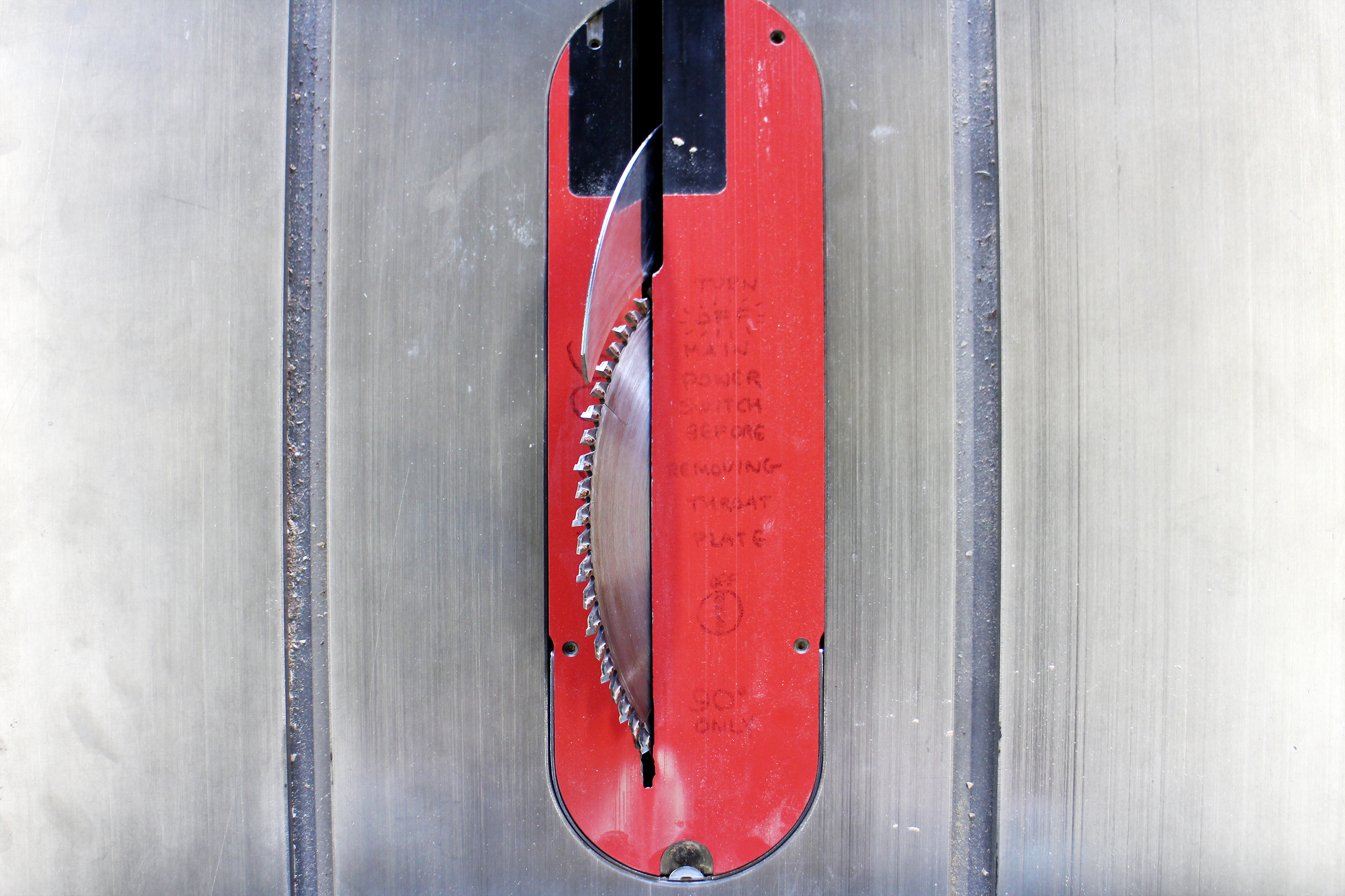

Step 1: Blade Selection
Before making any cuts with a table saw you'll need to determine which blade to use. Not all blades cut the same, and different materials will require different saw blades.
As covered in the Saw Blades section Tools + Materials Lesson, the easiest way to think about saw blades is the number of teeth they have. Saw blades with a low tooth count are great for rough cuts, making quick work for large volumes of work. The aggressive teeth are great for construction cuts that aren't meant to be of finish quality. Fine tooth saw blades make slower cuts, but the finish quality of the cut is much nicer. Great for cuts that will be the finish of your project. Higher tooth count blades are able to cut harder materials, like hardwood. With the right blade your table saw can even cut thin metals.
A very common blade is the combination saw blade, which has 40-60 teeth and is a great all around blade. This is the blade specified in the Tools + Materials list since it's versatile and I almost never change it out of my saw unless I'm doing a special cut. If you need to change out your saw blade, here's how to do it.

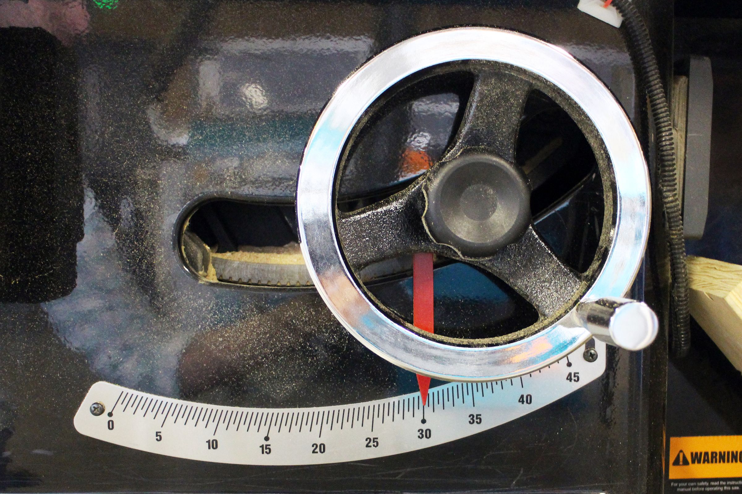

Step 3: Set Bevel Angle
Table saws not only make 90° cuts, but most saws are able to bevel the blade and create an angled cut along the length of your rip cut. As with all parts of the table saw, the bevel angle needs to be calibrated to ensure you're making square cuts.
If your table saw has a bevel function then there will be an angle scale somewhere conspicuous. Most saws have the bevel scale on the same face as the blade height wheel.

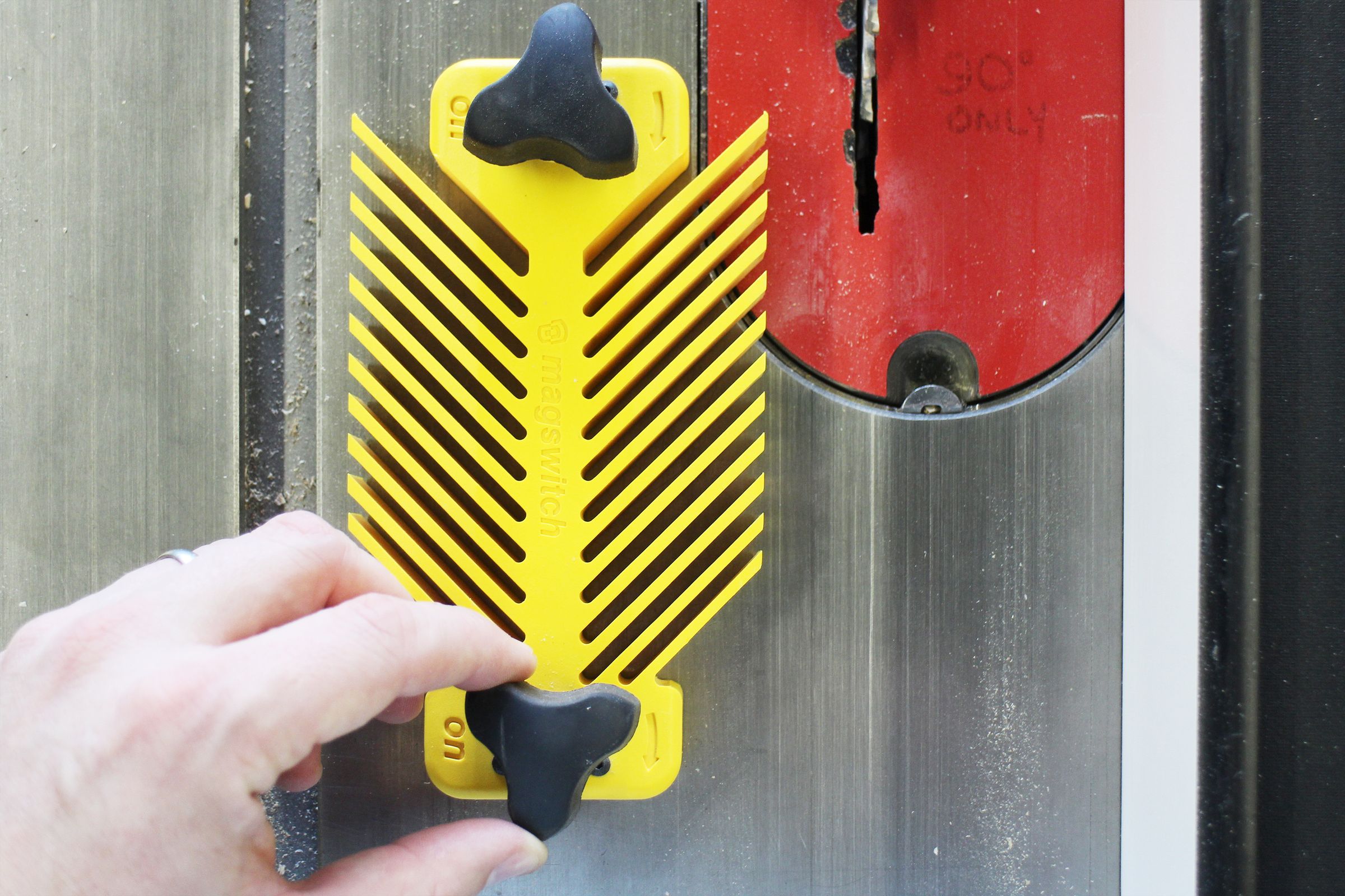

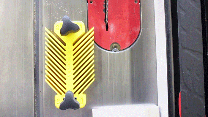

Step 5: Set Featherboard

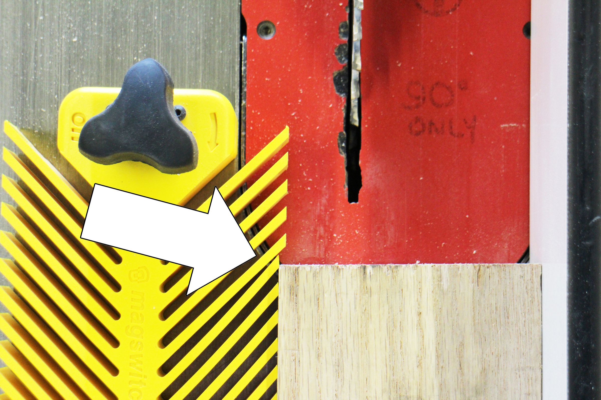

Featherboards apply pressure towards the fence and guide your material into the saw blade. Whether magnetic or the type that slide in the mitre track, featherboards need to be set between you and the cutting blade and close enough to apply adequate pressure to the wood.
With the saw powered off, set the fence distance and place your wood against the fence and abutting the blade. Move the featherboard near the blade with the angled feathers pointing in the direction you will be pushing, and push it up against the wood. The feathers should bend slightly from the pressure you are applying.
When you've got good pressure, lock down the featherboard and remove the wood. Turn on the saw and guide the wood through the featherboard and into the blade. This additional pressure will keep the material steady during the cut and will prevent any wandering that could occur from pushing the wood into the blade.

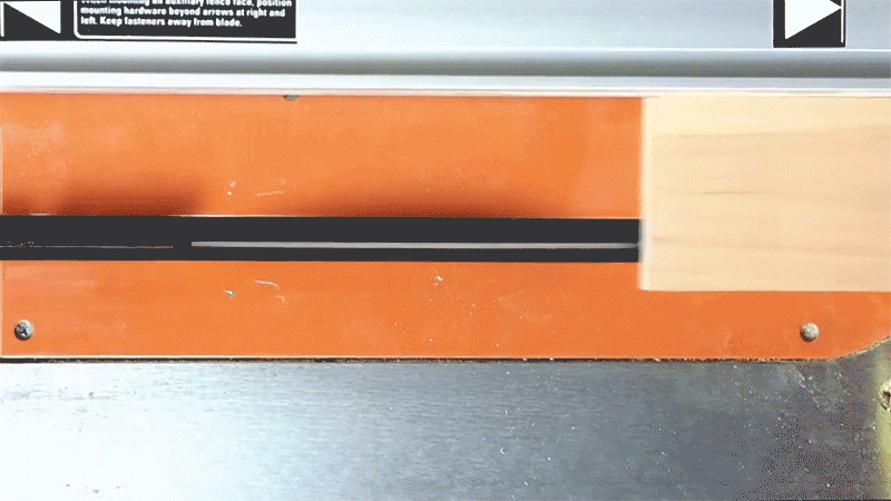

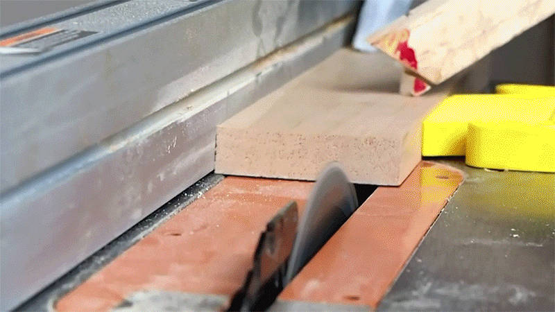

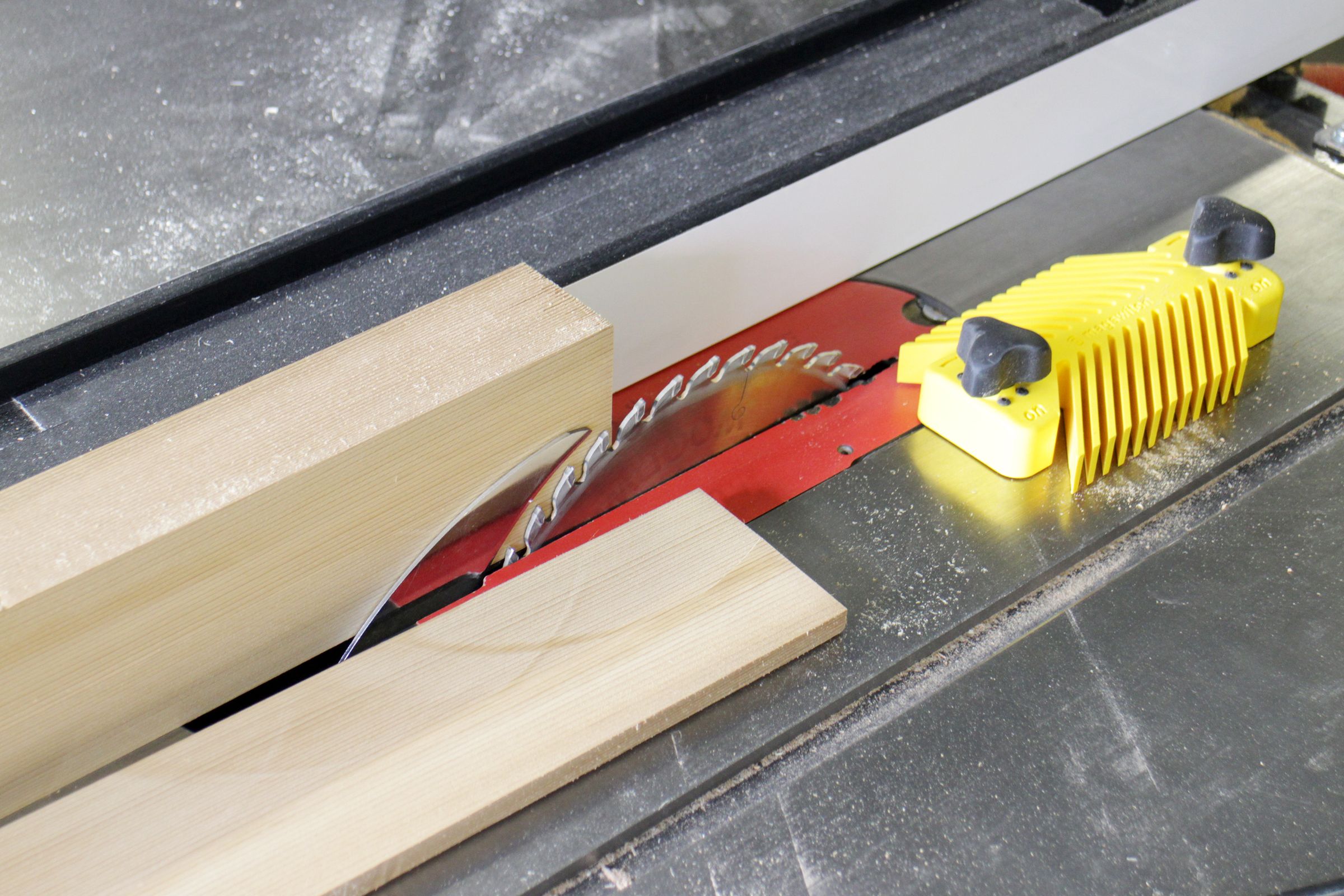

Step 6: Rip Board
When ripping boards you want to have the bulk of the material against the fence with the cutoff falling away from the blade. If you attempt to cut thin strips with the cutoff between the fence and the blade you introduce a high possibility of kickback.
With the saw all set up you're ready to make a cut. Using push sticks and standing just to the side of the wood, push the wood through the saw blade completely to make a cut.
With a little practice you'll be able to read the cut as it's happening, adjusting your speed and pressure on the push sticks to accommodate different woods, or woods with knots in them.
Make sure to turn the saw off between cuts.

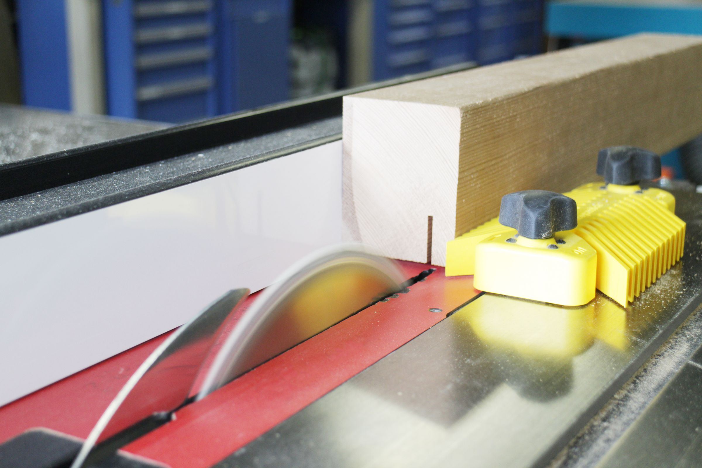

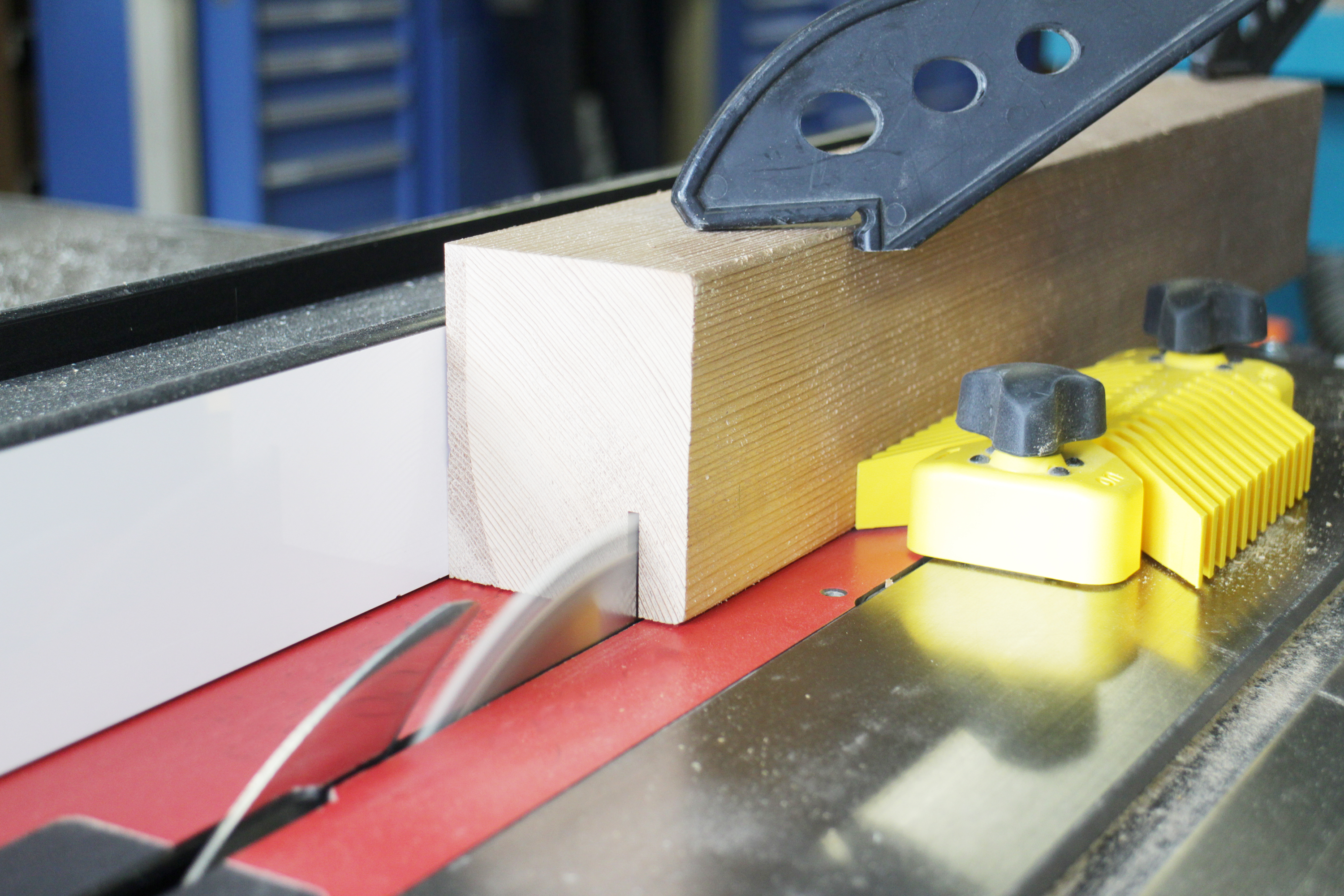

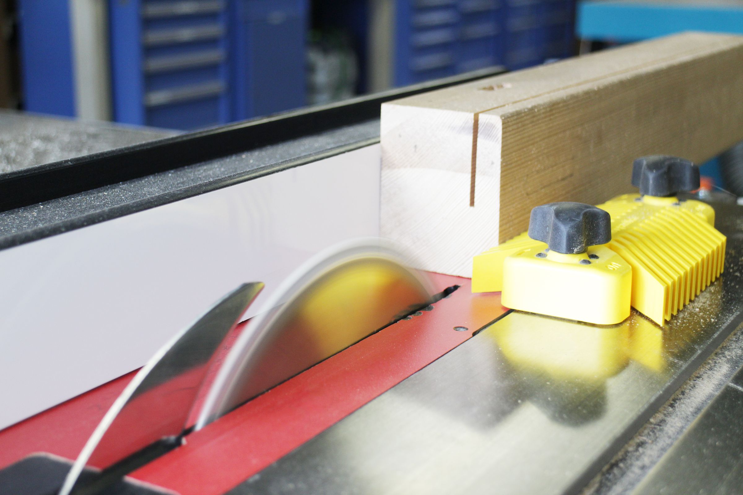

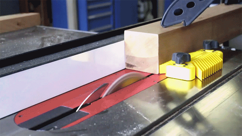

Step 7: Cuts on Thick Wood
Ripping thick wood is also possible on the table saw; no need to use the bandsaw! You can even cut wood that is thicker than the maximum height of your blade, too.

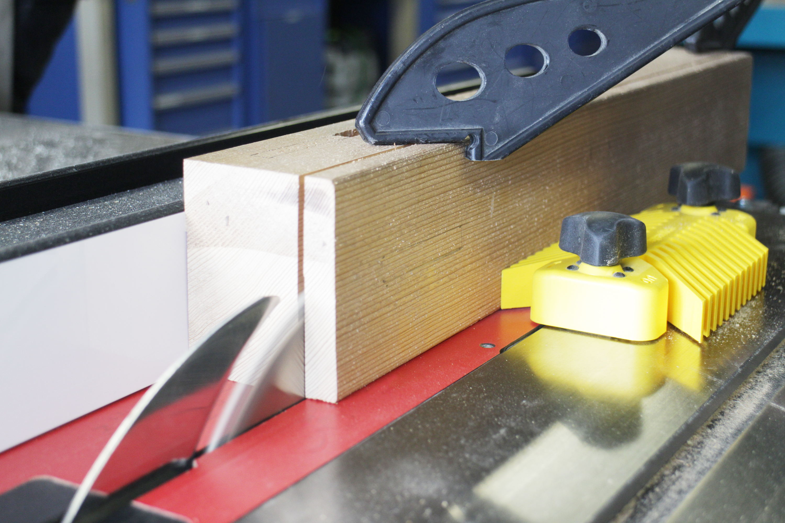

The trick with any thick pieces of wood is to do multiple small passes to achieve the cut. Set your fence to the desired scale and position the featherboard, like all other ripping operations. Start with the blade height no more than 1" high and pass the piece through the blade to start the cut.
After the first pass raise the blade up in increments until you cut through the wood, or you reach the maximum height of your blade. For most 10" saws this will be around 3" maximum height.
When you've reached the maximum blade height, keep the fence and featherboard where they are and just flip the wood over and align the cut channel with the blade. Repeat the same process of starting with a shallow up and raise the blade after each successive cut.
Here's a helpful animation that shows the process I used to cut this 3½" post. After getting to the maximum height of 3" I flipped the post over and finished the cut on the other side. There was no need to drop the blade lower on the flipped cut, since I was only cutting through the remaining ½" of wood.
