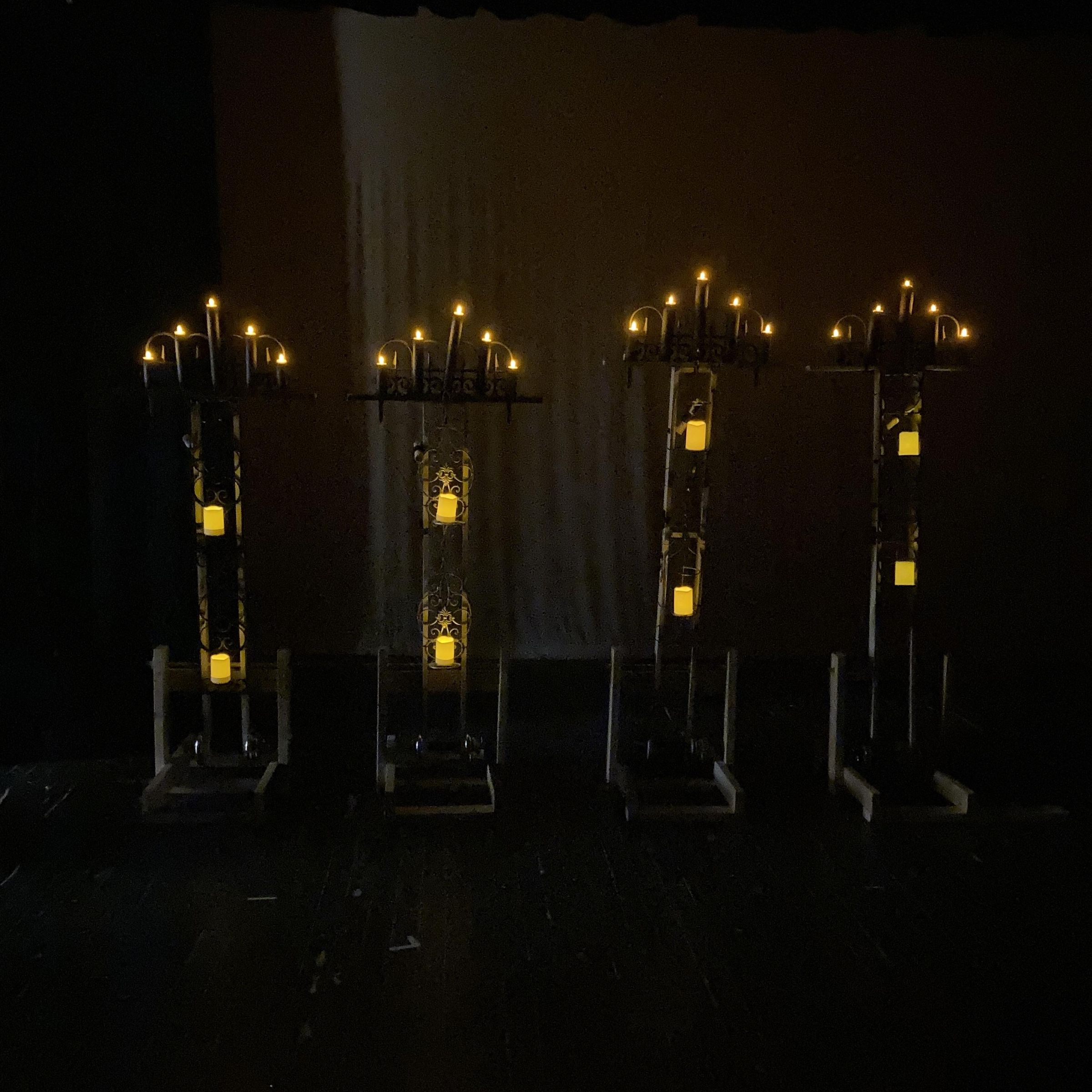

Our local high school summer theater program performed the Andrew Lloyd Webber musical, "The Phantom of the Opera". The director asked me to create candelabras that rise from a foggy lake. (Maybe it should be called a "Rising CandelOpera"?)
There were several constraints; no trap doors, no available fly system overhead, the candelabras must be setup in only a few seconds, 5 to 6 feet tall, and limited budget. Ideally it would be triggered to rise automatically. As a theater prop, it must be safe and robust (or at least robust enough to survive the small number of runs and rehearsals).

The design that I implemented was based on a seesaw mechanism. I considered different ways to raise the seesaw, including human operators hidden behind it, off-stage operator using a pole, screen door closers (not constant speed, not smooth), and bungee cords (difficult to adjust the force). I found that using a counterweight was smooth but tricky to get the weight just right to get an acceptable speed; if it was too heavy, the candelabra would rise too fast and then bounce back and forth until it settled in the vertical position. We decided to relax the requirement of being fully automated and allow an off-stage operator to control the rotation speed by releasing a string that is attached to the top of the candelabra.
There are a couple of important parameters to adjust in order to make this design work.
- Pivot Location
- Candle-Side Weight
There is a trade-off between how low the candelabra is when it is in its horizontal position, and the amount of counterweight that is required. The longer the counterweight side of the seesaw, the less counterweight is required (due to leverage), but this requires more bottom clearance to rotate to its vertical position, and hence raising its horizontal profile.
The candle-side should be as light as possible in order to keep the counterweight low and the counterweight side length small.

Step 12: Conclusion
I created the Rising Candelabra as a prop for a local high school summer theater program production of the musical, "The Phantom of the Opera".
Its design is based on a seesaw. It uses a counterweight to raise the candelabra. The advantage of this design is that it requires no external power, is quick to set up, and is robust. It is also very safe since there is only low voltage batteries, and there are no motors or high-tension springs. I rewired the candle LEDs to be powered by a battery pack with a single switch, to make the set up quick. I added caster wheels for quick setup on the stage, but these are optional for fixed setups. I added a tilt sensor to turn the LEDs on when the candelabra reached a pre-determined angle; this was not strictly necessary, but it added to the cool factor. To keep costs down, many of the materials were sourced from thrift shops and dollar stores, or reused from previous productions.
