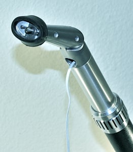

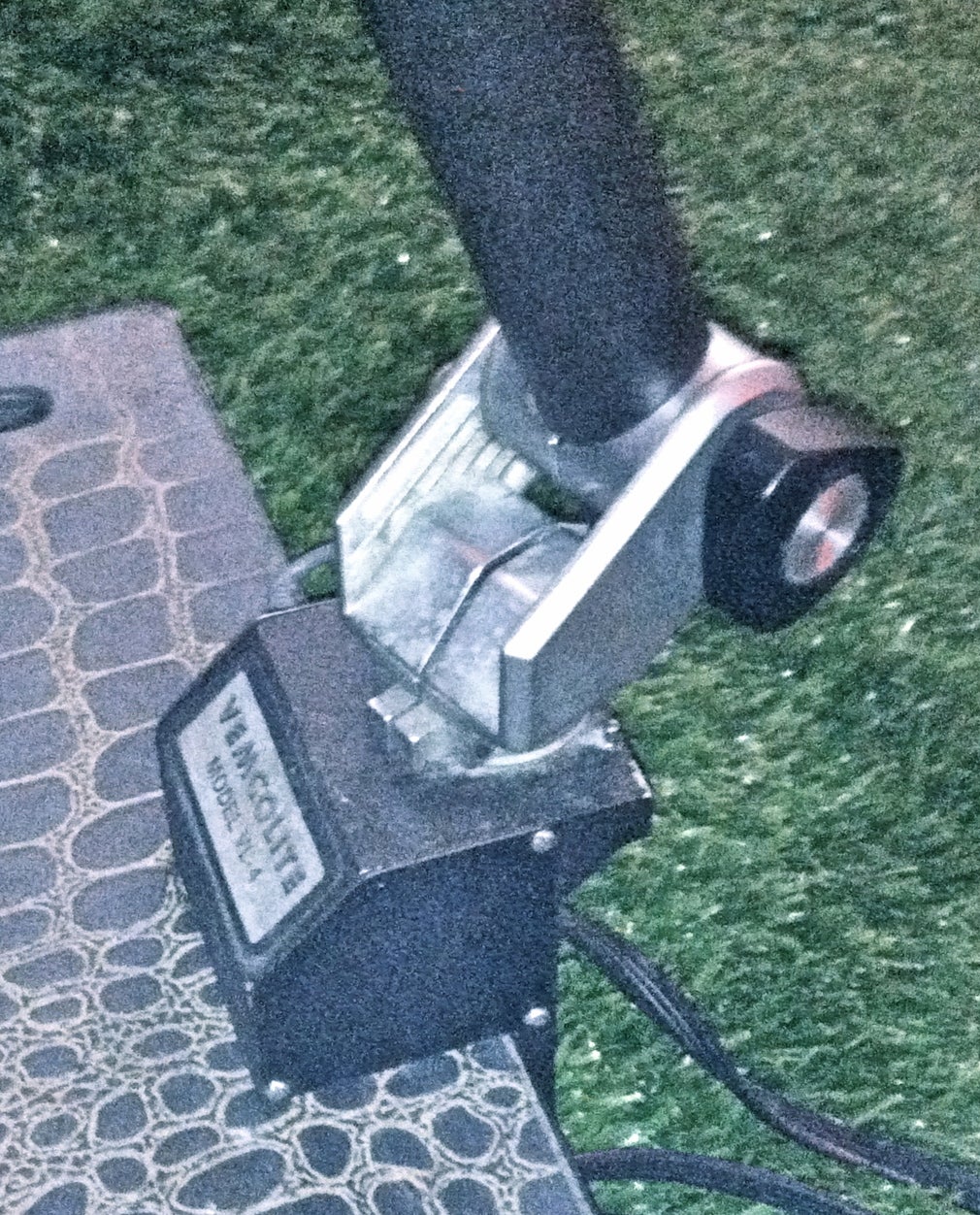

VEMCOLITE Model VL-4 Architects Task Lamp
Industrial Grade Suction CUp w/ Intergraded Vacuum Pump & Low Pressure Indicator
IPAD Wall Charger
IPAD Cable

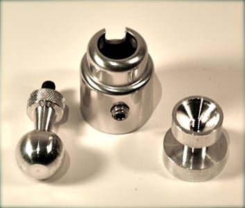

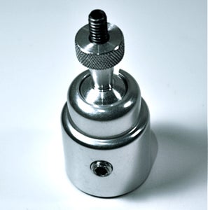

Security Camera Adjustable Ball Mount
5/16 x 18 Thumb Screw + Throttle Grip form a Harley Davidson
Stylus for the iPad
Rubber Bushing

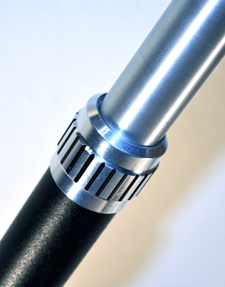

It wasn't easy deconstructing the Vemcolite VL-4, but it was well worth it. The performance is exceptional, effortless one handed positioning, smooth fluid movement and it stays where it's positioned. A very solid piece with the simplicity in the design is where Old inspires New. This makes for a very enjoyable experience when you are looking to relax or work on something..... other than the stand for your device.
