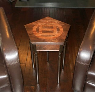

Who here has built a 4-legged table? That’s what I thought; ladi dadi everybody. Same with 3 and possibly 6, if you’ve used deployable legs to support extra leaves. What? You’ve got something wrong with 5? Although not often seen, a 5-legged table isn’t too difficult by itself but provides the opportunity to expand your skills.
I made a run through Myst and Riven recently and even after 20 years, I still find the artwork and style intriguing, not to mention the depth of the world imagined by Robyn and Rand Miller. Specifically, the numbering system in Riven along with their affinity for the base-5 system are unique and fairly well thought out. Since I’m working the early industrial look into the house and needed a table beside my armchairs, I thought it might be cool to sneak some gaming nerdiness in along with it.
The symbol will require a router/inlay kit which is pretty simple but I’d recommend some practice before committing to the final product.
And the legs? They’re busted-out stair/banister supports from a renovation. Something told me they’d come in handy. That’s where we’ll start.

Time to get down to business! In order to not waste a ton of material (you’d need a 15.5x16.5” square to start from), I’ll be making the top from several glued-up boards.
The outside angle is 108 degrees, aka 18 for your miter saw. Mark that on an end of your first board and measure the leading edge down the front… leave a little extra for slop and continue the angle up the other side. I recommend cutting as you go so the top doesn’t become unmanageable.
For the last two sides, leave extra room to trim the glued-up block back. Once you’re happy, break out the joint-making apparatus of choice and glue the whole thing up. From there, trim the angled sides back on the miter saw. I suggest starting on the good side, trim to the right, rotate the block and continue all the way around.
If you want perfection, plot a circle in the center that reaches the edges and trim back to where it meets. Don’t go by measuring the outside edge since each time you make one cut, you change the adjacent sides. If you don’t mind imperfections of +/- 1/8”, get close and leave it go.

From there, I went back to the router table and used another subset of a molding bit to get a table lip and bead on the edges… I also clipped the top corner off and needed to glue a new one on and try again. I’d suggest using a sacrificial backing board.

Since the legs were painted before and are maple, they’ll need to be refinished. To create a base, I applied a layer of gray milk paint and followed up with two layers of kona/java gel stain. I put it on thick and didn’t wipe any of it off. This gave a little bit of texture and helped mask the fact they were recovered from the stairwell.
The top needed a bit more work. I used a few layers of filler and followed that with a thick layer of gel stain. With it still sitting on the top, I dropped a load of saw dust onto the top and worked it by hand into the crevices around the symbol. Carefully sand everything back and get ready for varnishing.
I glued the legs up with a band clamp and then used a wipe-on polyurethane through a spray gun to apply the top coat. Sand the top between each layer at ~400-800 grit to remove the last few dents and separations between the top and the symbol.
To attach the legs to the top, I used a ring of metal L-brackets on the inside to hold everything together. I did consider pocket holes through the legs but this ended up being just as easy.
And that’s it! Add some felt feet, grab your linking book/smoking jacket and head off to D’ni city!
