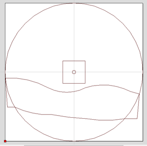

Step 2: Design Process
After we finished our sketches, we used Vcarve Pro to begin designing our clock. We first started by making the circle the size we wanted. It was a diameter of 14 inches. We then created a river shape that we liked and added that as well. We also added the hole for the clock mechanism, and the space for the battery, but we will get to that later. I also attached the file that we created, if you just want to use that one!
Step 3: Creation Is Born
After completing our design we took our 15 by 15 piece of wood shelving and cut out our river. By cutting out the river first we were able to get the resin all the way to the edge, and not worry about spilling any resin over. The machining time was not long, and our clock idea was born.

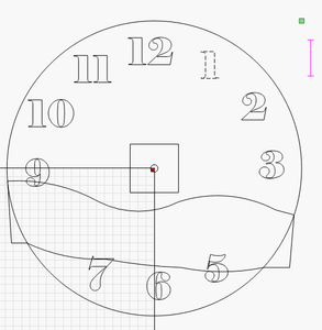

Step 7: Laser Cut Numbers!
After having a finished river we needed to think about how we wanted to do our numbers. We decided that we would cut an additional piece of MDF the same diameter as our original clock that we could laser cut the numbers into, and then properly line them all up. We then re-ran our CNC cut to make the circle, and then laser cut our numbers on the board. We imported our Vcarve file into LightBurn and chose a font that we liked.
