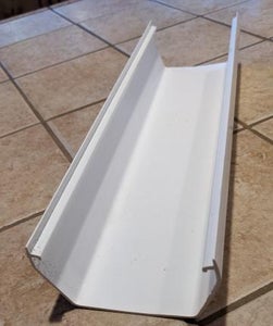

  • "Contemporary" Half Round (U shaped) Gutter - I found mine at Lowes and it comes in 10 foot lengths for around $11 US. Make sure you get the Contemporary gutter, a cut section is shown in the image above and not the K style gutter. I ended up using 4 lengths but needing only 3. $33

  • Measure the interior dimensions of your tank. Mine ended up being around 71.5 inch long and 22 inches high.
  • Decide how high you want the grotto wall to be. I wanted mine to be around 1 inch from the top, so each section of gutter needed to be 21 inches.
  • Determine how many gutter sections are needed. The gutter is around 4.25 inches wide, so the most I calculated I could fit was 16, with 4 inches left over.
  • Determine how many section per gutter. The gutter from the store comes in 10 foot, or 120 inch, sections. Dividing 120 by 21, gave me 5 cut sections each. Which at 16 cut sections needed, meant I needed to purchase 4 gutters from the store.
  • Determine how many panels you will make. Unless you are installing into a small tank, you will need to connect multiple gutter sections into panels in order to install. I would suggest making panels of 5-6 segments if possible. The fewer panels the easier it is to hide the seam between them. However the more segments in each panel, the heavier it will be and the more difficult it may be to fit between the aquarium wall and any bracing. When determining how wide a panel can be to fit between the wall and the bracing, factor in the 2 (or more) inches that rocks may add to the panel width. I was originally going to go with 3 panels, 2 of 5 segments and one of 6 segments.

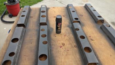

  • Drill cave holes in gutter. The first time I did this, I just cut 2 1/2 inch holes. This time, since I had the bits, I cut 1 1/2", 2" and 2 1/2" holes and made sure they were offset to make it harder to see the individual gutter sections. There is no real rhyme or reason to their placement, other than to try and keep them from lining up horizontally as much as possible. When you drill the cave holes, lay out out the gutter segments next to each other and number them. That way you can see how the holes play off of each other and you can assemble them in the same order.
  • Cut an angle so the gutter clears the tank silicone (Optional). - Cut off what will be the bottom back corner of each section of gutter. This is optional but it helps the gutter sit flush with the bottom. The cut doesn't have to be drastic or accurate. I used an angle grinder with a cutoff disk to cut a section 3/4 inch tall by 2.5 inches long, give or take.
  • Drill holes in side for attachment. The gutter segments will be attached together with zip ties, so choose a drill bit a little larger than the width of the zip tie. Then clamp two segments which will go together and carefully drill 3 holes down the common side. The hole nearest the top should be 3 inches from the end, you will be making a handle using this hole. Since these holes will be used to attach the segments together, you do not need to drill holes on the faces facing the outside of the panels.
  • Sand and clean up the gutter. In order to help the paint stick to the gutter, you will need to rough it up by sanding it. I went with 80 grit sand paper, since that is what I had, but 120 grit should work also. At this time, you should also clean up the edges of your cuts and the holes you drilled in the gutter.
  • Spray paint the gutter. I ended up doing 5 coats and also made sure that I painted the cut sections of the holes. I didn't do that in my old tank and it bugs me that from certain angles you can see the while of the cut holes. The Krylon paint supposedly fully cures after 7-8 days, so I let it cure for a week before I started the next part.

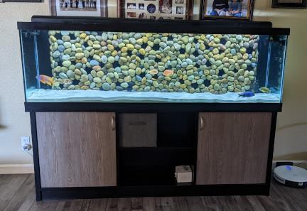

I have read that silicone needs to cure 48 hours to become aquarium safe, however because I wasn't in a real rush and I had finished applying the rocks late Sunday night I gave mine more. It ended up being 6 days before I installed the panels and another week before I added water.
For the installation, since I have a 3d printer, I designed and printed custom clips to hold the background on. Because they were custom designed for my tank, I haven't included them in this instructable. However you can use the lead wire to attach the background to the aquarium. The background requires very little horizontal force to hold them in place.
  • Prep work - If you are installing in an existing aquarium, you will need to drain around 25% of the water to allow for water displacement. You will also need to clear out enough space in your substrate so that the panels will with on the aquarium floor.
  • Attach lead hook - Cut a 6-8 inch pieces of the lead wire and attach one end to the each of the zip tie handles
  • Install in tank - Once you have maneuvered the panel into place, bend the other end of the wire over the top of back of the aquarium. You can then bend it to help hold the panel tighter to the back wall. I would also take a 2 inch piece of lead wire, bend it into a U and use it to clip the panels together. This will keep the panels from separating.

  • Part way through the build I had second guessed myself and went with 15 gutter segments instead of the original planned 16. I was thinking I it would be a hassle to put the filter intakes behind the background. I regret that decision, as I don't like the way the black background reflects of the side walls. I am hiding it with plants but I wish I would have put the intakes behind the two end gutter segments. I may fix that at a later date.
